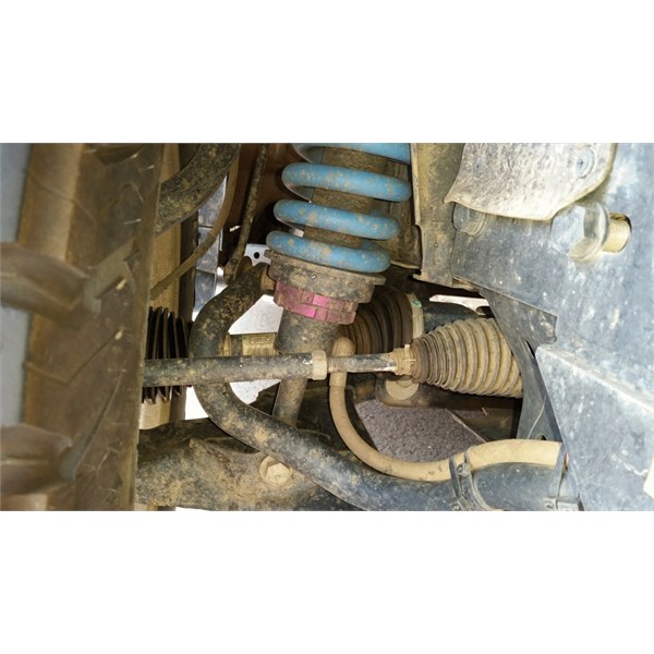

Follow Up By: Frank P (NSW) - Friday, Dec 23, 2016 at 10:48
Jackolux,
I watched all your vids on the Army Tk. Very interesting and good quality, unlike many. It was the Ranger that caught my eye because I have a BT50 (almost the same) and I wanted to see how it went.
I can't do vids, but here is a still of my front suspension at rest on a level surface. I have a Lovell's GVM upgrade to 3500kg and an ARB bar and winch at the front. When it was all new 2 years ago the lift was about 40mm at the front, but it's settled a little bit since then.
You can see a bit of drive line angle, but not nearly as much as on your Dmax.
I haven't had the chance to look closely at a Dmax, but I wonder if they have a bit of drive line angle out of the factory to account for settling, and then even a mild lift takes it a bit too far.
Perhaps Santa will leave a diff drop kit under the tree :-)
Merry Christmas
FollowupID: 876628
Reply By: Jackolux - Friday, Dec 23, 2016 at 12:14
Frank I think your drive shaft looks fine , if mine were like that I wouldn't be worried.
Hopefully I can get mine sorted because having to spend 3 hours winching up a track because you are reduced to 2WD is a pita .
