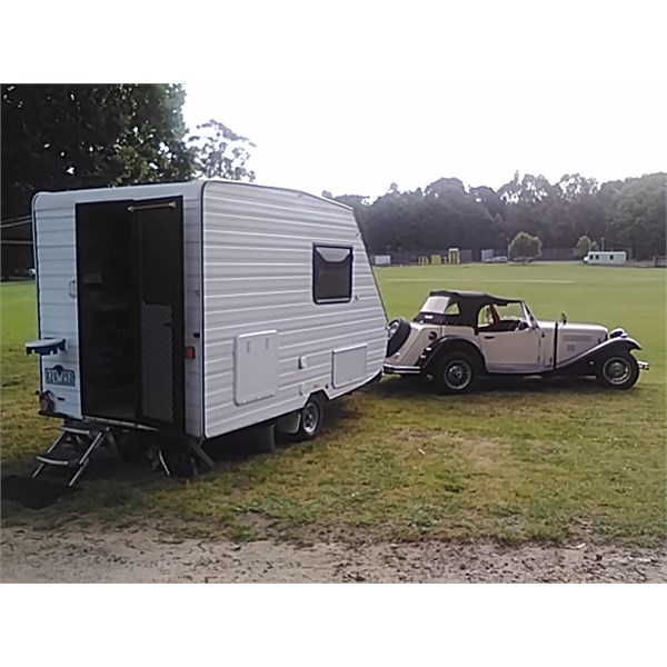

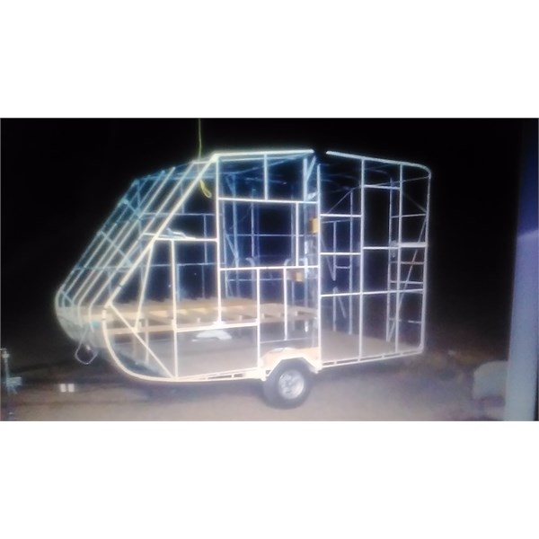

Agree with all the above. However for the financially strapped, a $150 eBay gasless might can be OK.
I used an arc for the bigger chassis welds and might gasless for the frame if thus very lightweight van. The frame was made with 13x13mm x1.6mm tube. I rarely put a hole in the tube with the gasless. Some joins had gussets and the van did a "lap" in winter thus year.
So gas is the way to go, gasless on a budget IMO
