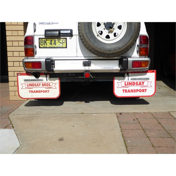

I put a couple of truck mudflaps on a bar that I can bolt / unbolt on the back of my truck. minimal cost compared to rock tamers.

Wonder about the overhang of the flaps at sides - ever been chatted to by a sworn officer or transport inspector about it ?

Yeah they do look a bit wide there will be a legal limit in place for modified items protruding out wider than the width of the vehicle. I wonder how things would go if a pedestrian cracked their shin on it or it was determined as to have contributed to an accident with another vehicle or motor bike or cycle.
Other than the width issue they look ok.
