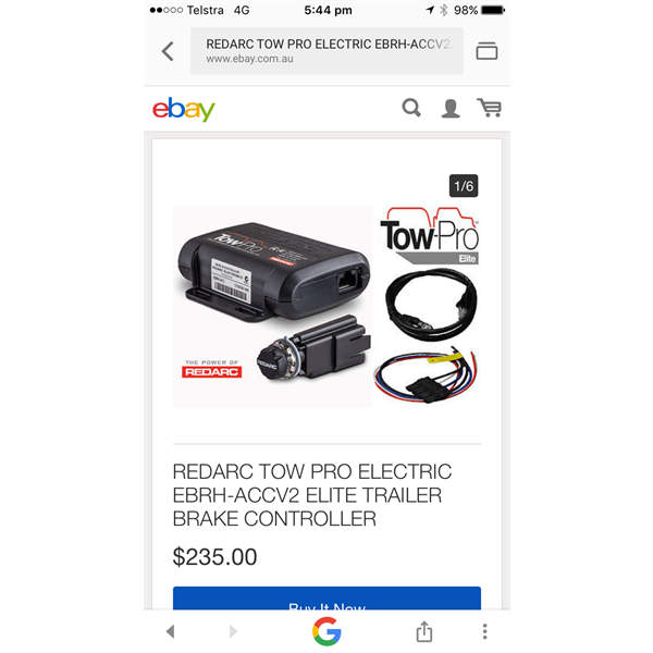

Follow Up By: Been-Everywhereman - Monday, Apr 17, 2017 at 17:47
Don't worry about where the controller goes if you buy compact type like the one here. the little knob is all you see poking through the dash. Leave the bigger ones alone.

The Redarc Towpro can be hidden, with a small knob mounted on the dash somewhere. It is neater and is out of the way. Again the knob should be mounted so it can be used by the preferred hand for manual override. It is neater installation. I think it's slightly more expensive than the P3
It has an off road mode which is good for steep downhill tracks.
Either will be ok. the P3 is probably easier to use and definitely reacts quicker. Expect to pay $180 - 250 on ebay or $400 if you let your Auto elec buy it. Plus fitting.
