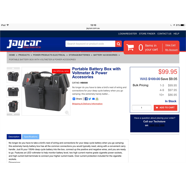

Follow Up By: Bob Y. - Qld - Wednesday, Apr 26, 2017 at 18:06
I bought one of these battery boxes from Jaycar back in 2015, and it has lasted well. Only repair has been replacing the clear cover on the voltmeter. Also, to be truly versatile it needs an Anderson plug fitted to it, which I haven't done yet.
Has done 3 Simpson crossings so they are robust.
