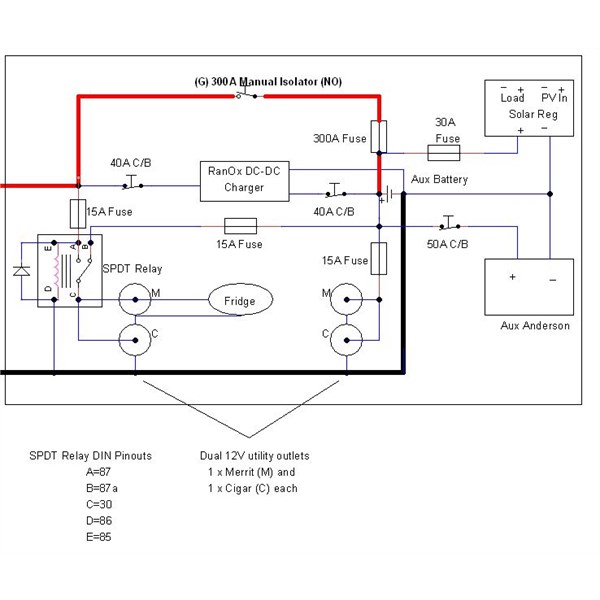

It is simple to improve your setup to get the max out of your Ctek.
You need a 5 pin (single pole double throw, or SPDT) automotive relay like this one.
Supply the coil from an IGN source in the car. Wire the normally closed contacts to power the fridges from the aux battery. Wire the normally open contacts to power the fridges from the vehicle's electrical system when the engine is running.
Here's how it looks on my setup. The red line is an IGN-controlled source. The Ranox DC-DC charger is like your Ctek.
