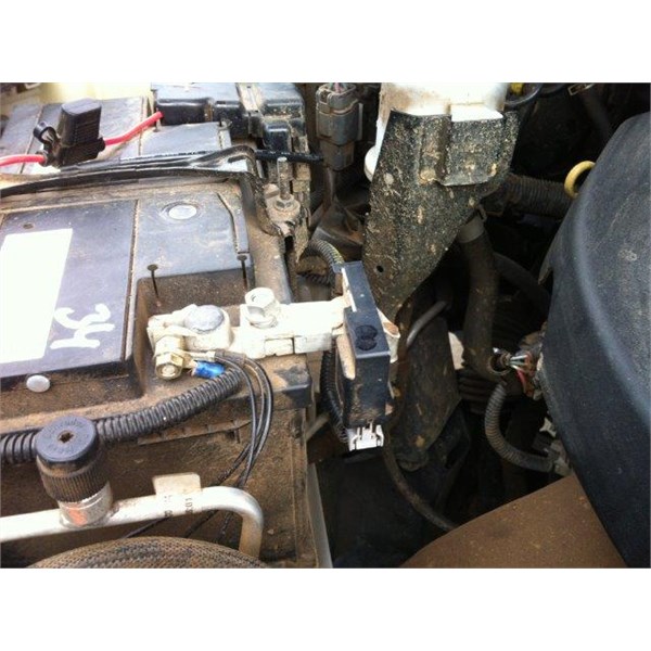

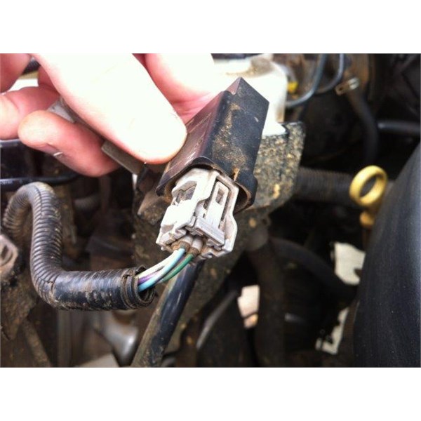

Thanks for the info, my son's ute doesn't appear to have this 'black plug' on the neg side of the start battery - see photos of his set up -
So not sure of where to go now as there is no black plug but a grey connector plug on the neg side of his battery, is this set up similar to the one you mention in your reply? and would this be the plug - it has 4 wires going into it.
Howard
FollowupID: 883592
Follow Up By: Member - Andy M (QLD) - Sunday, Aug 20, 2017 at 16:43
Sorry Howard, yes that is the one to remove. I've had mine taped up with black tape so was thinking black. Just uncovered it and it is grey, the same as in your photo with four wires into it. That's apparently just measuring the current at the battery and sends a message to the ECM etc to help it decide whether to change the charging voltage. If its not getting the message it behaves as a normal alternator.
It's a bit of a mongrel to undo but just depress the bottom wide part of the plug as in your second picture and give it a bit of a wiggle and it should come out.

Follow Up By: Member - Howard P (WA) - Sunday, Aug 20, 2017 at 20:34
Hi Andy,
Thanks mate, all good now. Removed the plug and went for test drive, alternator output now reading 14.3 vdc as opposed to yesterday after the same run where it went down to 13.1 vdc.
The young bloke says he owes you a beer - next time he is in QLD
Howard
FollowupID: 883611
