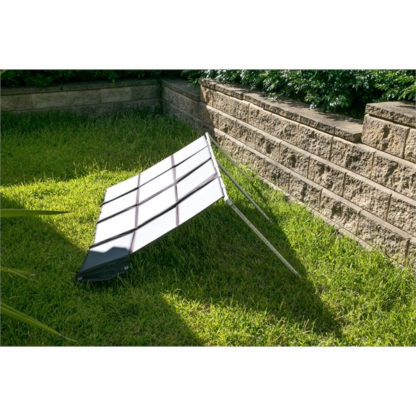

Hi Saltydog, after a discussion with my son in law, we finally decided to purchase a solar blanket Brand- Projecta 180w. As my daughter could not get a good discount from work for this item, so we searched online and found that one of our local auto parts distributors was selling this item for $950- , whereas they normally sell for about $2005- mark ($1750- was the best my daughter could go). My s-i-l is a industrial electrician and checked all the features out, and we bought 2 with a further discount. Not sure where you are from but, the company is R&E autos in Cranbourne and Pakenham Vic. They are selling online, and we picked up from there Pakenham store. Multi battery combination and only 8kg, far easier to carry than our 240w bifold panels with much greater weight. We also checked that this item was the same part number as we saw on all other sites. We cut off the 2 alligator clips just prior inline fuse and installed an Anderson plug to both sections to make it more universal. how this helps a little
location - Warragul -Victoria

I'm also using a Projecta, nice unit. I also have a Super cheap one and have two normal panels on the van that are detachable. I did also use a traditional folding type but thats been relegated to the spare room these days.
Blankets win hands down, lighter, take up less space etc. The projecta are good units in that they also come with a stand setup, its a bit mickey mouse but is functional. The supercheap blankets put out more than they claim, so do the Projecta from memory. The regulator supplied with the Projecta units though is a rubbish bin job unless they have improved them, the Projecta regulators are a good unit but these days I don't use the regulators on the blankets, I just plug the blankets straight into the car or van controller.
The only bug bear I have with both blankets is the cover material, it collects grass seeds, burrs etc, I always set them up on a plastic tarp or put them on a table etc to minimize.

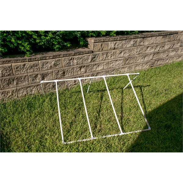

As above the Projecta have a stand, the supercheap I just lay on the ground, you can more out of the Projectas but continually repointing them but I find you still get a good return from the supercheap just laying on the ground and you don't need to repoint it that way though you might have to occasionally drag it into the sunshine if there are trees about.

Thanks mate, very interesting that you have all 3 Solar PVs
My only thought with the blankets, is it would be hard to set the correct panel angle to follow the sun most effectively.
As with a solid construction, you can swivel East through West and set the desired angle
Nice to know the Projector has some kind of frame.

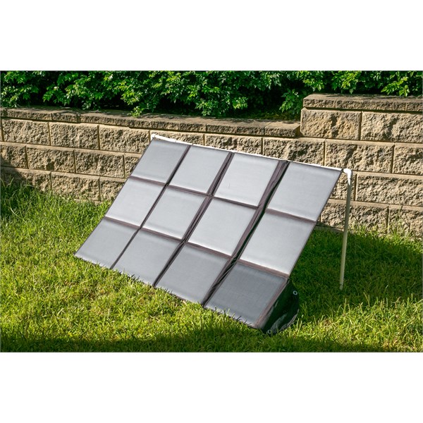

I had a 160w suitcase style folding one, which weighed a tonne and took up heaps of space.
I replaced it with a Projecta 120w. Best decision I ever made. It takes up a fraction of the space the folding one did, which means it fits in a lot of other places for storage. There’s also a not insignificant weight saving.
It takes a couple of minutes more to set up, but its output is better than the previous one.

We have had the 200w rigid type solar panels for a couple of years and they have performed great. They are very heavy, large and cumbersome to handle.
Bought a 190w Redarc solar blanket and couldn't be more happy, 6kg instead of about 22kg, fold up to 30cmx30cmx6cm instead of 80cmx60cmx10cm. We can just tuck the folded blanket away in many spaces in the vehicle compared to the rigid panels taking up a huge amount of space.
We just lay the blanket flat on the ground which works great, of course we could have done this with the rigid panels but they have a frame so you feel compelled to use the frame and that can be painful moving them (3 folding panels all joined together all wanting to go their own way). I wouldn't even consider buying rigid panels now.
