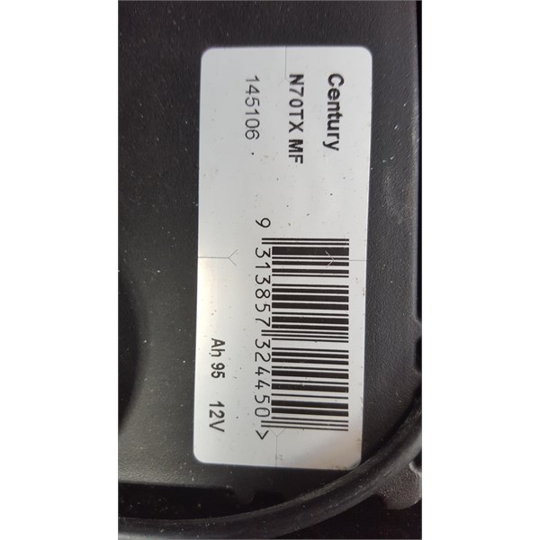

Hi. I am trying to diagnose whether i have a problem with my solar setup. I have a 100ah battery installed in the back of my ute. It has a redarc system attached which works as both isolator and regulator. I use a 140W solar page to charge the battery. While travelling full time i used this system successfully to run an 80L fridge in the back of ute, led lights and 12V plugs in caravan to charge phones laptops etc. Voltage in the morning would generally be down to 12.6, 12.5 depending on what we had used the night before. I recently got the battery replaced as old one was only charging to 12.4V. However I seem to be getting way less power with the new battery. I am only running the fridge now and have been plugging it in to 240V during the day while I charge battery via solar panel. The battery is showing 13.3V and redarc is on 'float' within 2 hours of plugging in solar panel in morning. When I unplug solar the voltage drops back to the fully charged volts of 12.9V. I unplug fridge from 240V at about 9 or 10pm and plug it into battery supply for overnight running. However by morning the volts are down to 12.2 or lower. Why would it be using so much power? The fridge supposedly uses 1-1.5 amps/h on the setting I have it on.

Is the new battery the same capacity as the old - ie same amp-hours?
AnswerID: 617956
Follow Up By: Dee78 - Sunday, Apr 01, 2018 at 10:17
FollowupID: 889784
Follow Up By: Frank P (NSW) - Sunday, Apr 01, 2018 at 10:23
95 Amp hours. What amp-hours was the old battery?
If the new battery is significantly smaller than the old, that could account for at least some of what you're seeing.
FollowupID: 889786

Hi Dee, the 95 amp/hr battery has 5% less capacity than the original and that is enough to bring the overnight voltage voltage down approx 12 volts. However, you say you are using less connected load, then I would suspect the battery is not getting fully charged and suspect the Recarc unit. Where is the Redarc located in relation to the pane and the battery; at or near the battery is best.

Standing voltage will be a little less with the current Century WET flooded than an AGM type
