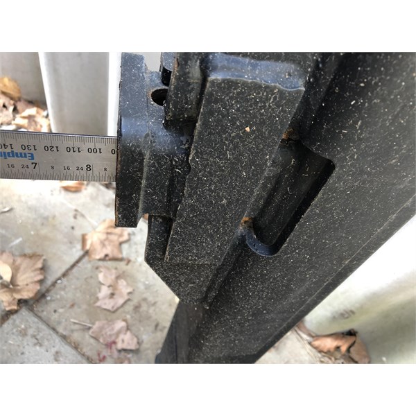

Reply By: nickb - Wednesday, Feb 20, 2019 at 16:13
What’s worse is that the receiver on the Ford Ranger towbar only butts into the main crossbar so there is only about 80mm of tongue inside the receiver...
AnswerID: 623993

Follow Up By: nickb - Thursday, Feb 21, 2019 at 20:45
My apologies, it’s actually 90mm. It also has some bracing welded around the lip of the receiver, Ford had a few instances where the hole elongated due to the short length.
This is a picture of my old towbar, my new towbar allows the tounge to go in as far as required.
