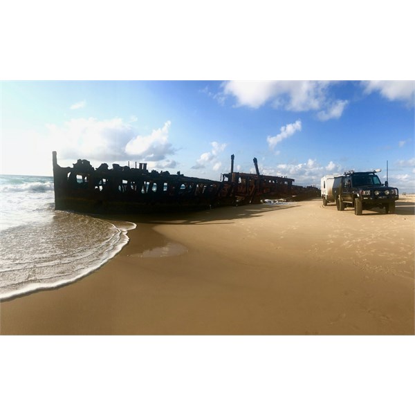

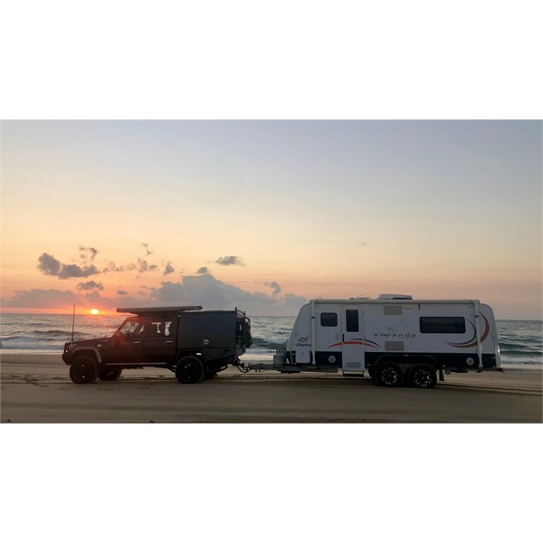

Haven't found it a problem on bitumen roads when towing our 17ft Jayco Expanda with my dual cab 79 series, but mines a dual axle van and alot will come down to how your van is loaded / laid out IMO over the tow vehicles skinnier rear wheel track. I did notice my 79 was a touch skatey on gravel of The Plenty Highway when towing our Kimberley Kamper across it about 18 months ago, something I had not noticed in all our previous outback trips when towing the same camper trailer with my previous 105 series Landcruiser......hopefully the new diff / axle correction I did back in September has solved that issue now though, it certainly was a nicer vehicle to drive on Fraser Island in the sand after doing the correction.

Thanks for the reply , nice set up. What company did your axle mods.?

A mate is a part owner of a few TJM stores (mine was done at Coopers Plains), i had them chuck a DWIZ diff in it.....they’ve done a few of them aswell as JMACX conversions now.

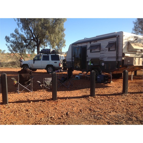

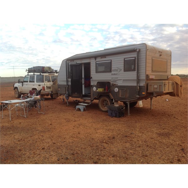

We had a MY10 76 Series and towed an 18’ 2.5 T single axle Elite Off Road van without any issues. The rear end of the 76 was standard, no correction, had no problems either off road or on road. Highway driving at 100 kph, the rig felt very stable, no sway. The only thing we did to the rear end was add “airbag helpers“ to correct the “droop” when the van was connected. Found this had a very profound effect on the handling with or without the van. Even before we installed the airbags, the van did not want to wander, but the rear end did want to “wallow” up and down a little, the airbags settled it down, as well as correct the droop.
