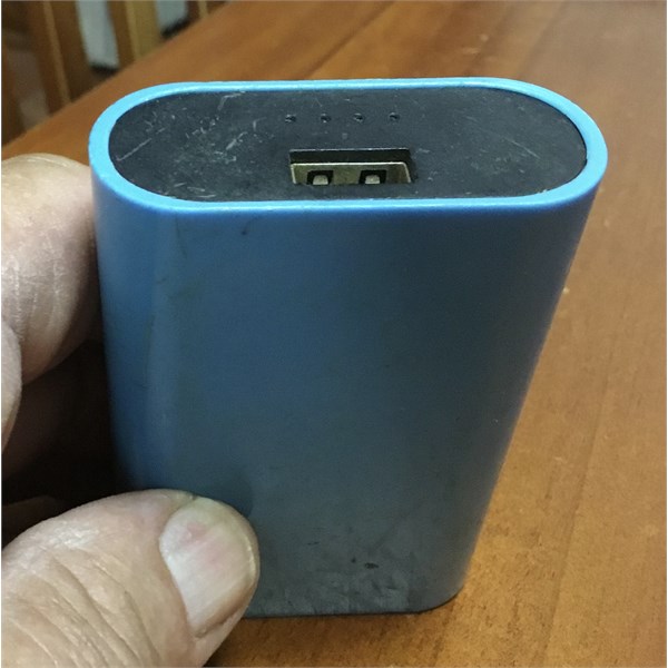

You’d be be better off fitting a USB outlet in your vehicle, Garry, or perhaps buy one of these, in photo, and keep it charged in the event of any blackouts.
Don’t recall the capacity of this one, but it is big enough to recharge a phone almost fully. There are higher capacity versions available from likes of JB Hifi.

Follow Up By: GarryR - Monday, Jan 13, 2020 at 05:59
Hi Bob Y, i thought of a battery pack but still remained in the same position of charging. If power went down for several days, the likes of the cfa radio would last 10-12hrs on continuous use, and phone subject to use 30hrs. I did not want to continually let the vechile run just to charge up appliances hence portable generator or dynamo. Thnks for the input
