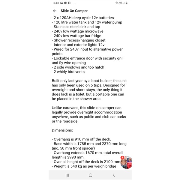

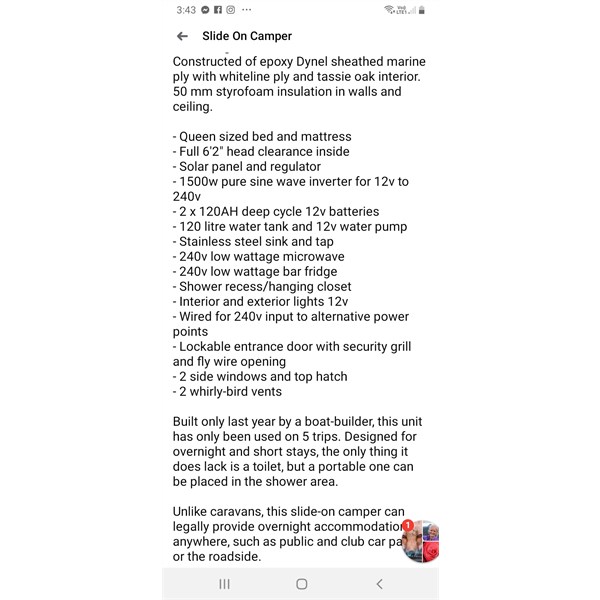

I am very new to the camper world so upfront please forgive my ignorance. I'm wanting some advice on this custom made slide on camper. I have attached 2 screen shots of all the info re the camper. I needed to know if this is something that will be suitable as a self sufficient home and if the dimensions and load weight and weight distribution is all out of whack or ok. Also if the frame material is ok.
I am slowly learning but this was a nice unit and I wanted to see if it would work. Appreciate any advice. It's very new. Bit ugly outside

What vehicle are you going to put it on? Most important. Do you have a picture of it on the seller's vehicle?

You haven't said what your vehicle is, for a slideon that long you would really need a full size 2400 tray.

The two 120ah batteries and associated solar and charger PLUS the full water tank and pump is approaching half the stated weight. If it has a frame , shower bed and roof, I find it hard to believe the weight stated is near true. Be careful and check that. Others have mentioned size of tray etc. All good points made to take notice of.

That 1670mm overhang sounds rather large. I'm thinking bent chassis maybe.

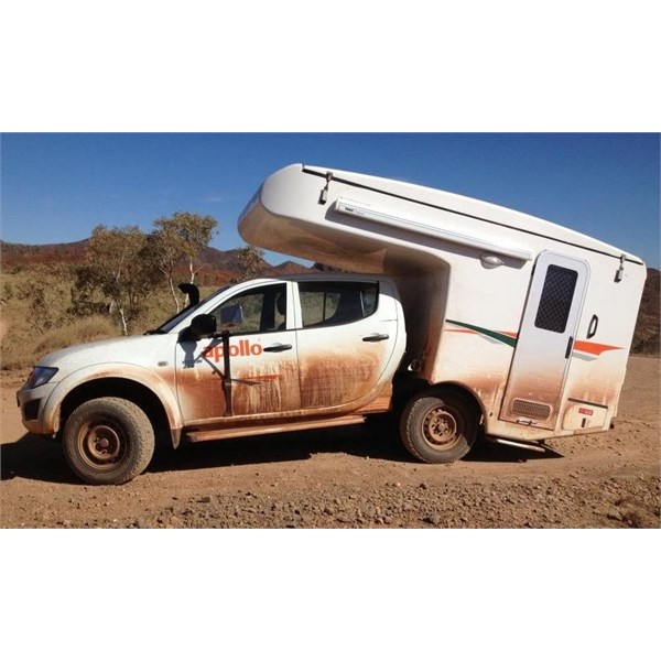

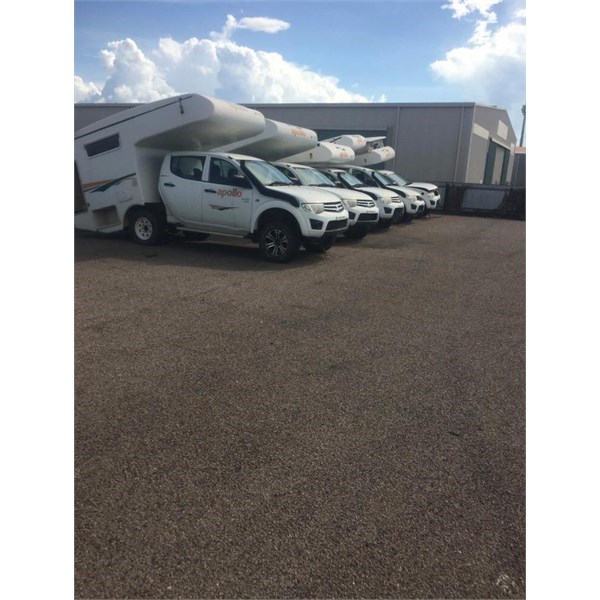

It all depends on use and setup but I would never consider a Mitsubishi anything ute. The propensity to crack chassis is alarming. I know a different setup, but the pic which appears at the base of these pages with 5 Mitsubishi Triton slide on setups ALKL with brocken chassis is indeed worrying. Used within their capability ok but stressed for travel maybe not.

Ang, here are a couple of images of the Mitsubishi Triton that have come to grief due to excessive weight.
