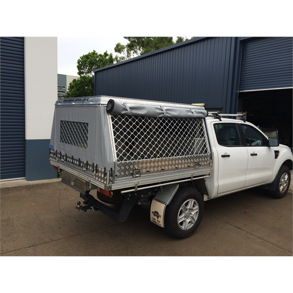

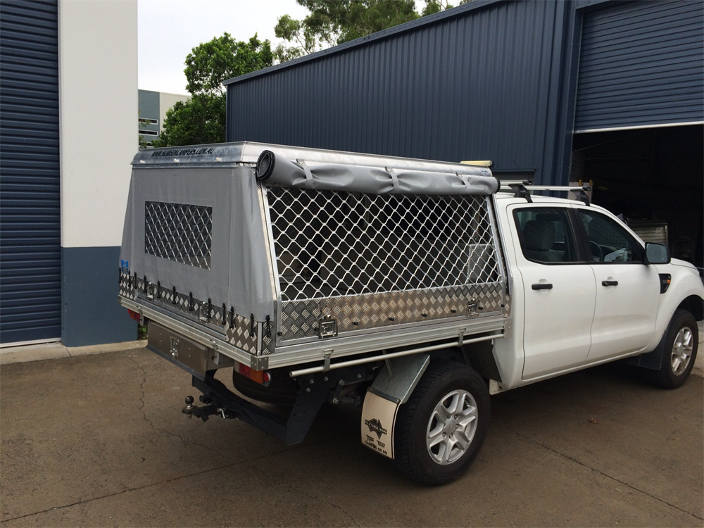

This is a canopy I was offered by Dynamic Engineering in Hervey Bay, but I opted for a full alloy one.
The extrusion around the top edge has sail track along all sides, and a key way is situated just behind the sail track, that accommodates the head of 8-10 mm bolt. Very versatile!
