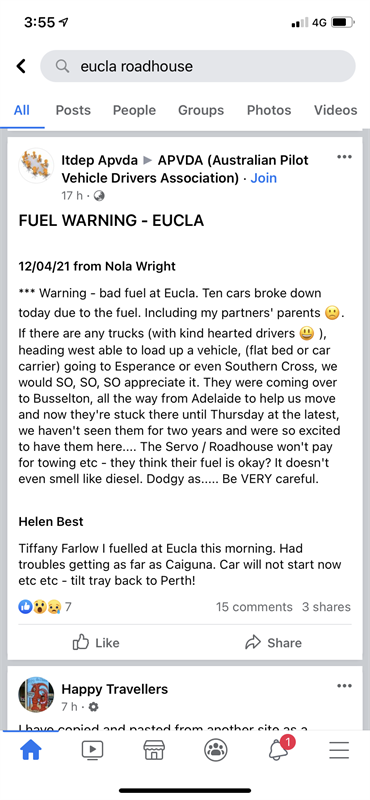

Careful where you buy fuel
Submitted: Tuesday, Apr 13, 2021 at 16:28
ThreadID: 141393 Views:10377 Replies:12 FollowUps:16
Reported on several sites Eucla roadhouse got the wrong fuel in the diesel tank

Just an update from our RAA motor body organisation here in South Australia about this serious problem.
Tests have pointed out that it is not contaminated dirty fuel but more serious......
They can not say how, but the Service Station some how had petrol put into the diesel tanks.
There were over 12 vehicles that had to be put on flat top recovery vehicles with repairs to vehicles going to countless thousands of dollars.
The Eucla Caltex is now looking into how this has happened and wether the fault has been caused by the tanker driver that delivered the fuel, or from the fuel depot that loaded fuel into the fuel tanker.

I was one of the unlucky ones, 1HZ 105 cruiser towing a van, main tank empty before fill up and yep switched back to main before heading off. Got just past Cocklebiddy before she started to play up, turned around and luckily got ourselves into a gravel pit before she died. This was on Monday, we couldn't get a tilt tray till the Thursday as they were so busy, luck we are fully self sufficient.
I think you'll find this has affected far more than 12, I have met a few, I have also heard much larger numbers but all rumors at this stage.
I'm insured with CBA, big mistake as not covered, rang them. I'll have to pay for repairs and claim everything back, lucky ours isn't a common rail otherwise we'd be up poop creek.
I have been in discussions with Eucla Motel Hotel who have been ok but also not saying too much at this stage, lucky we kept our receipt. I'm just worried about the blame game and how long before I get reimbursed.
A bit of blah blah but might be of interest, cheers Bob
