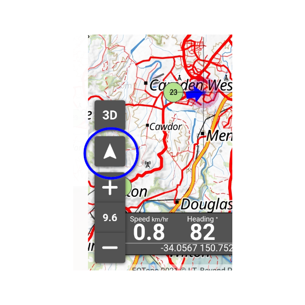

"Annoyingly our blue arrow now doesn't stay centered, it just moves off the screen, but I'm sure there's some setting somewhere to try and make it stay centered. I might start working on that now."
Tap the GPS lock (circled). That will start moving map and keep your blue arrow on the screen. Read the manual because there are other settings you will discover on this. After reading, experiment, You can do no harm.
