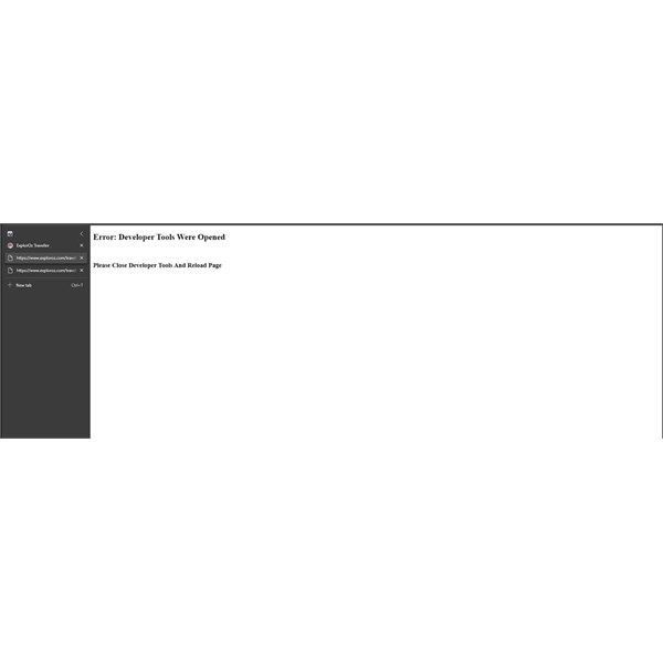

Hi All
Could someone tell me what this error message means and how to overcome it?
The browser I'm using is the latest version of Edge, which should be supported.
Error: Developer Tools Were Opened
Please Close Developer Tools And Reload Page
Thanks in advance to all you tech wizards

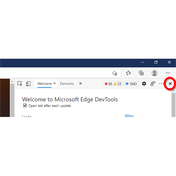

When you open Edge, do you get this:
If so, click the circled X and try again.

Hey Frank - just responded below - the issue they are having is Vertical Tabs - I could see this in the initial image - going back to horizontal tabs fixes the issue. I am not sure how easy/hard it will be to get around vertical tabs as it offsets the screen width in the same fashion as dev tools.
Thanks for you always valuable help and assistance to the community.

Yeah the tabs being on the side will cause the tools tester to trigger by the looks as the total screen width is greater than the html page width. This is one of the checks for the dev tools system. I will have a play with this at some stage however at the moment I am 100% on the Track Log updates and have been for about 7 weeks so far - getting over it and just want it done but still need a fair bit more work yet. Big update.
David

The error you are having is related to having the vertical tabs - this makes the system believe the tools panel is open. Please switch back to horizontal tabs and the issue will go away.
David
