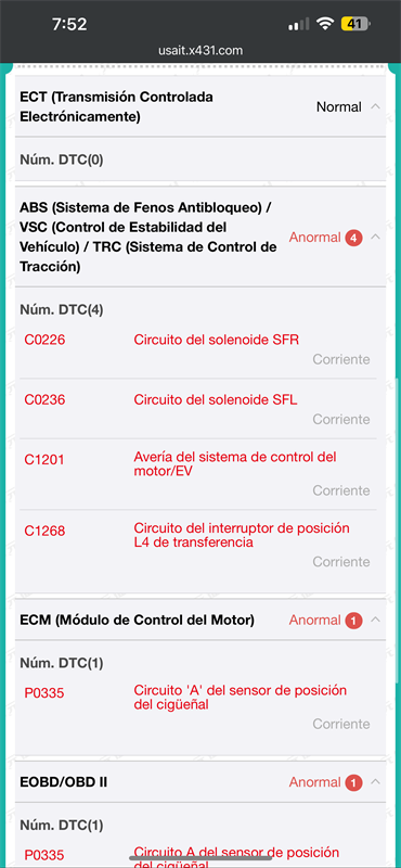

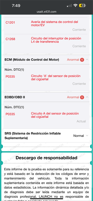

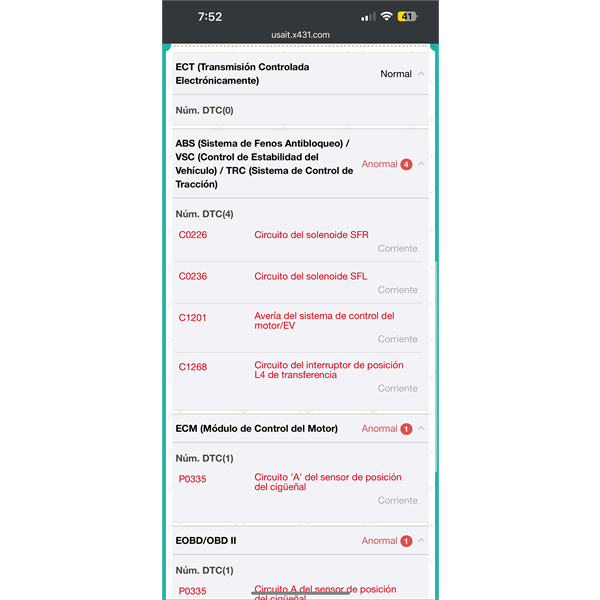

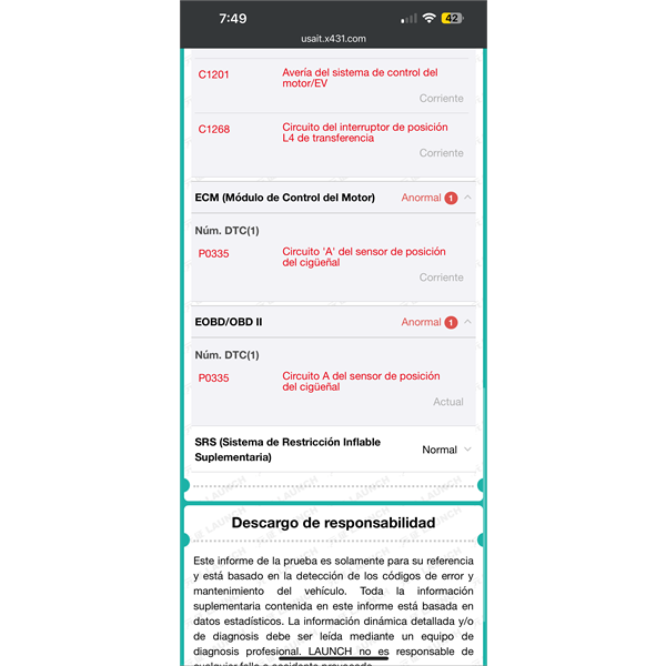

The codes that shows are the following:
P0335
C0226
C0236
C1201
C1268
FollowupID: 928495

And have you bothered to look up what they mean, or do you want others to do it for you?
I am not trying to fix your problem, just giving you an idea of how to diagnose it yourself.
FollowupID: 928498
Follow Up By: Andres M - Saturday, Feb 22, 2025 at 11:10
Yes here I have the Computer Diagnose but is in Spanish. Sorry
