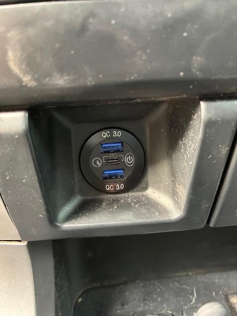

On the weekend I drove
home over a 2 hr journey, and I noticed that despite my iPhone 16E being plugged into a USB power point, the battery level was dropping to the point that it was down to 26% by the time I got
home. This was a bit of a worry, as it would suggest that ExplorOz plus ApplePlay running through my phone would only be good for about a 3 hour trip.
I contacted Michelle and David about the power useage rate on my iPhone and was advised that I needed a power source called a USB PD. As luck would have it, I had one that I purchased recently from Amazon-they cost about $27.

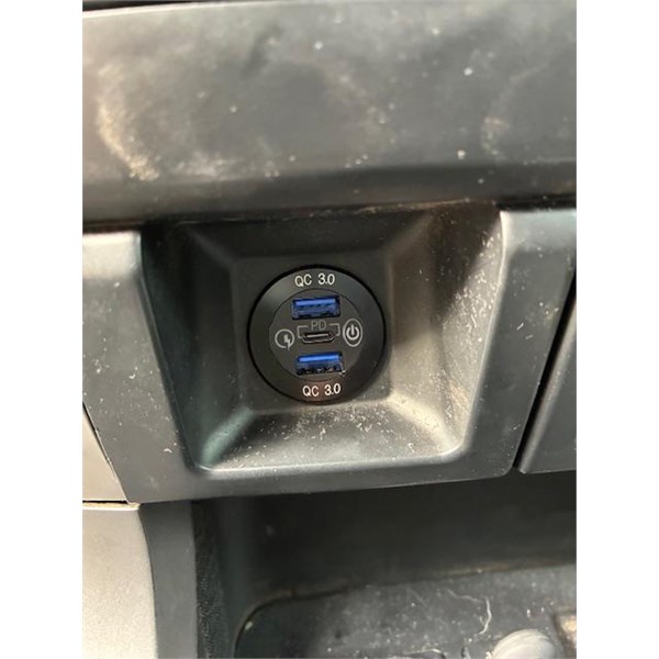

Today after installing the USB PD socket, I connected it with a USB C to USB C cable to my iPhone , and I'm pleased to be able to report that the socket was charging my iPhone at a rate greater while I was running ExplorOz and ApplePlay. Problem solved.
Attached are photos of socket for your reference.
USB PD
