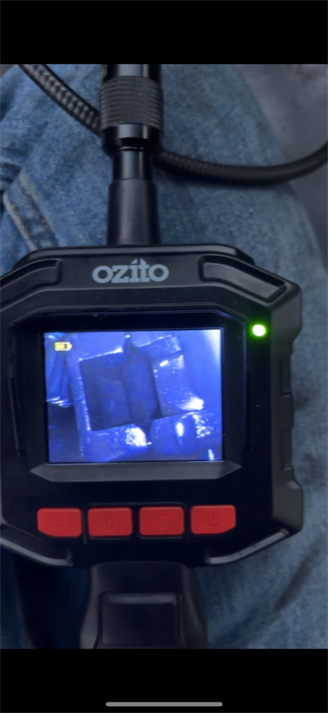

Sounds like its not lined up properly for some reason, have you tried removing the gear stick and putting the selectors into neuteral?

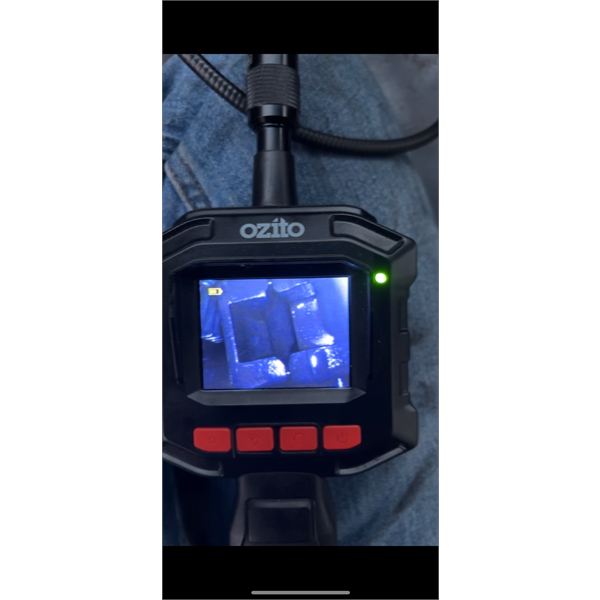

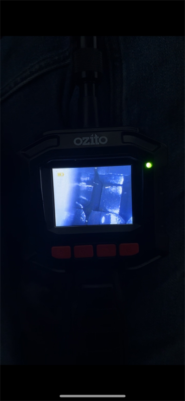

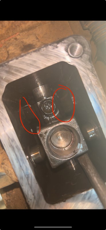

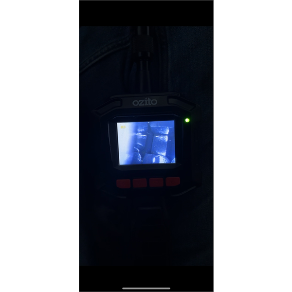

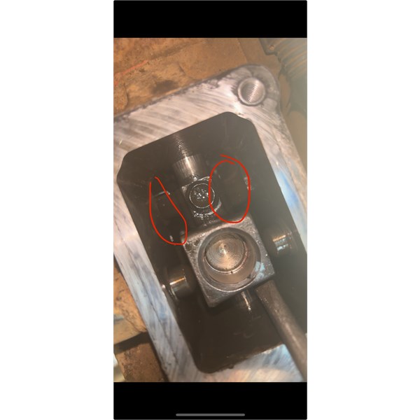

Hi LeighW, I've pulled the gear stick out and the top housing for the stick off, I can see inside the box where the selector shafts are attached to the selector "box" not sure if thats the correct name for it. I will attach a few images so you can see what I am talking about.
Gearbox selector arms
Reverse and 5th selectors
1st and 2nd selectors
