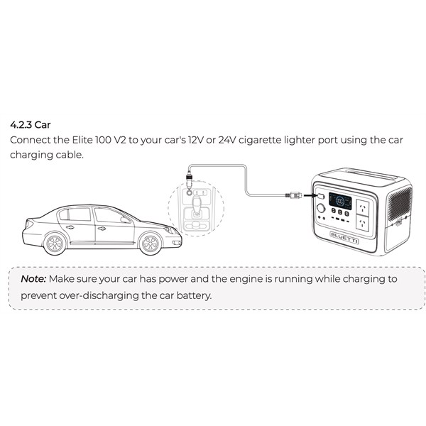

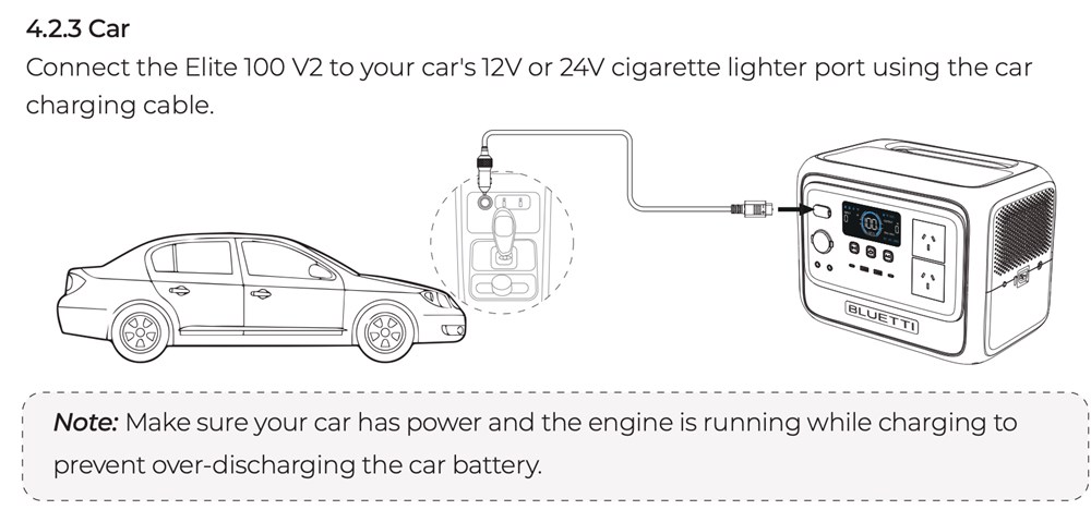

Reply By: IvanTheTerrible - Wednesday, Aug 06, 2025 at 18:31
You cant have a battery in the cabin of a vehicle unless it's fully sealed to the cabin and vented to the outside.
AnswerID: 648385
Follow Up By: IvanTheTerrible - Wednesday, Aug 06, 2025 at 18:49
The cig socket probably will not supply enough current and w ithout a DC-DC will never provide a good charge voltage
FollowupID: 929651

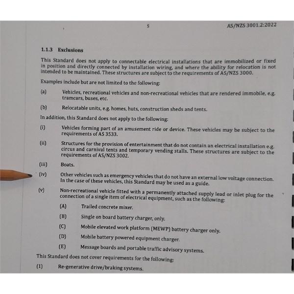

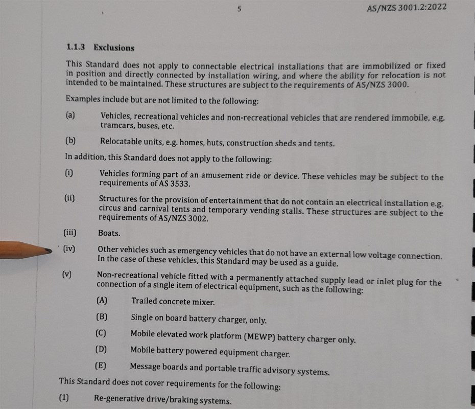

Follow Up By: Peter_n_Margaret - Thursday, Aug 07, 2025 at 16:43
Allan, I am pretty sure that AS/NZ 3001 does not apply to ANYTHING that is not "Connectable" ie. capable of being plugged into the grid (and everything - with some specified exemptions, that does).
My OKA can't be "plugged in" and it therefore AS/NZ 3001 does not apply. What does apply though is AS/NZ 3000 due to the power distributed from the inverter via hard wiring.
The fine print is critical with this stuff..... It is hard work to comprehend sometimes.
This is a list of exclusions I acquired form somewhere. Edit: says "2:2022"
My conclusion is that if the NON recreational vehicle (car) is "connectable" then 3001 applies.
And if it is NOT "connectable" the 3001 does NOT apply.
FollowupID: 929673
Follow Up By: Allan B (Sunshine Coast) - Thursday, Aug 07, 2025 at 18:33
Peter, You say that I am "Wrong again" but that is not so . AS/NZS 3001.2 has a title of "Electrical installations — Connectable electrical installations and supply arrangements."
Under "1.1 Scope" it includes "Section 1.1.2.2 Recreational vehicles: (a) Caravans, (b) Campervans, (c) Motor homes, (d) etc.etc. and a range of non-recreational vehicles.
My point of argument with Ivan is that he said a "customer's car failed a roadworthy" due to non-conformity for lack of a sealed battery box. Well he did not say "motorhome" etc, he said a "car" and I very much doubt that the car was not arranged with a 230vac inlet socket in order to qualify as a "Connectable unit".
DISCLAIMER: Leigh makes a point that….."All batteries must be adequately supported and secure. In addition, if fitted in a luggage or occupant compartment, the battery must either be of a type that is fully sealed or be located within a sub compartment which is vented to atmosphere outside the vehicle."
And I can well believe that. When it comes to electrical matters, Victoria does not necessarily conform to Australian Standards as do other States but "goes it alone". I have had the pleasure(?) of working under Victorian electrical regulations who refused to recognise my South Australian Electrical Workers Certificate and I had to be examined and qualify all over again to qualify for their certification. It is not just Victoria either, even those States that adopt the AS/NZS 3000 often have interpretations and additional requirements. It can make working Commonwealth-wide rather difficult.
Peter, you highlight an image from AS/NZS 3001 that states about "Other vehicles may use this Standard as a guide" which means that although these vehicles are not embraced with the Standard's requirement, it is suggested that they may find the Standard useful as a guide." But not a requirement.
Yes, the "fine print is critical" and I am very familiar with interpreting these Australian Standards (and others) in the performance of my work.
My over-riding point is that Ivan's expression should not be taken at face value without considering the specific circumstance. Ivan is good at throwaway expressions.
Incidentally, this may be a good opportunity to point out that AS/NZS refers to "Lithium ion" batteries and makes no distinction of a LiFePO4 battery. however, I have had communication with the Standards organisation and they consider that a LiFePO4 battery (Lithium Iron Phosphate battery) is a type of lithium-ion battery. So do not consider that a LiFePO4 battery is not excluded from the requirements.
FollowupID: 929678
Follow Up By: Peter_n_Margaret - Thursday, Aug 07, 2025 at 19:08
I agree with your post detail Allan, but "Non connectable = Not applicable".
https://www.australiastandards.com/product/as-nzs-3001-2-2022/
"Specifies requirements for electrical installations associated with connectable electrical installation s used for the purposes of accommodation, habitation or other residential, commercial purposes or recreational uses that are intended for connection to external low voltage a.c. supply systems (i.e. 50 V a.c. to 1000 V a.c.) by either a detachable supply lead or a supply lead directly connected to the connectable electrical installation. Includes requirements and provides guidance for the installation of extra-low voltage systems (i.e. less than 50 V a.c. or 120 V d.c. ripple free)."
OKA 196 motorhome
FollowupID: 929679

Reply By: Member - nick boab - Friday, Aug 15, 2025 at 08:29
Have a crack...
AnswerID: 648416
Follow Up By: Allan B (Sunshine Coast) - Friday, Aug 15, 2025 at 12:21
I don't understand why that bloke is feeding his Bluetti from the car battery via a DC-DC module.
I believed that function was already incorporated within the Bluetti as evidenced by the instruction book below:
His whole procedure seems rather complicated.
FollowupID: 929722
Follow Up By: Kenell - Friday, Aug 15, 2025 at 16:48
Allan, the cable referred to in your attached diagram is the cig lighter cable connecting to the cig lighter socket. Bit confusing I agree but that is what they mean. For maximum charging from the DC circuitry the DCDC option is required at around $380 as I recall. The "Have a Crack" link highlights the simplicity of the installation which effectively renders the cig lighter in your diagram redundant.
Kenell
FollowupID: 929726
