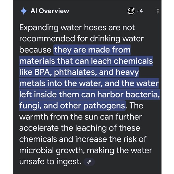

Unfortunately every expanding hose I have seen states they are not to be used for drinking water ??
