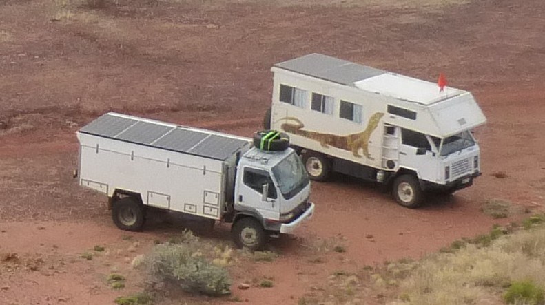

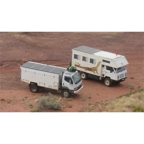

I have a friend with a Canter with 4 similar panels on the roof, mounted in the conventional way.
We recently drove the Canning (and other places), without any issue.

Follow Up By: Peter_n_Margaret - Saturday, Jan 31, 2026 at 15:01
Pic.....On the Canning, 2024.
Have no close up pics :(
Those panels did the southern Canning in 2024, northern Canning, Hamersley Range and Anne Beadell in 2025 and is now in Tasmania.
FollowupID: 930537

Follow Up By: Peter_n_Margaret - Saturday, Jan 31, 2026 at 21:34
3 @ 160W plus 3 @ 200W plus 200W as an awning over the rear window.
