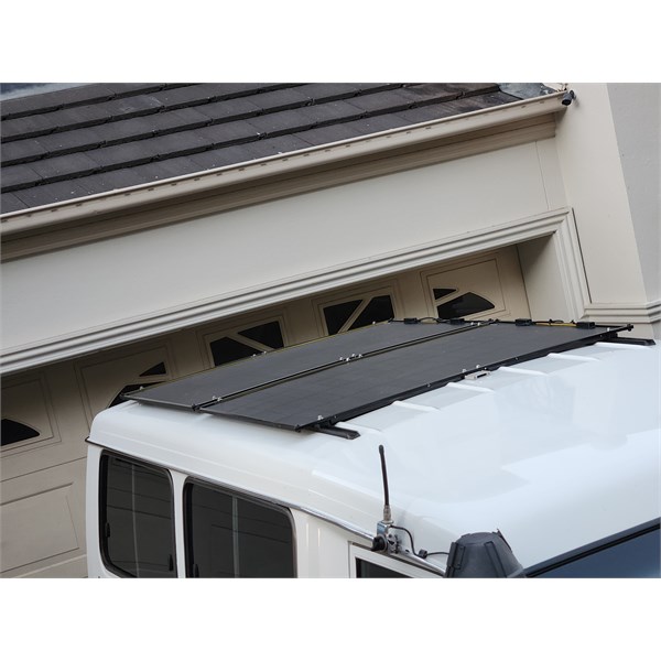

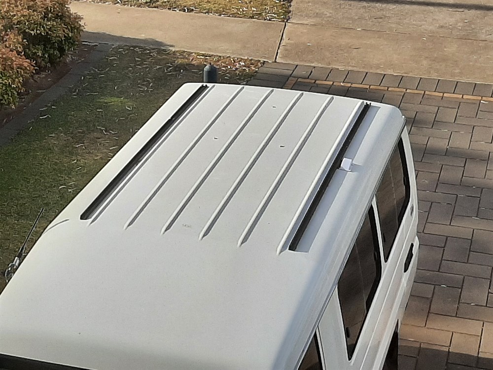

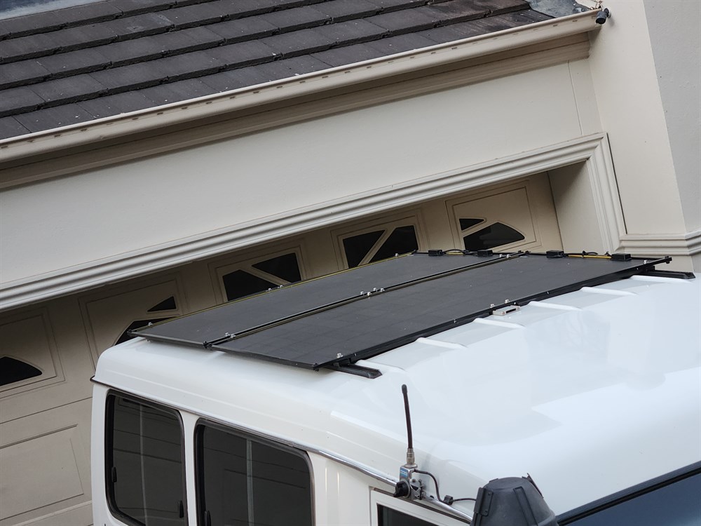

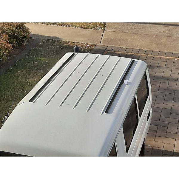

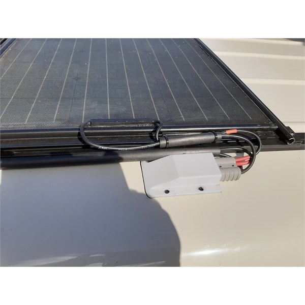

Reply By: Phil G - Friday, Feb 06, 2026 at 09:38
Gday Lyndon,
I have a 2019 Troopy that is 2100 high and a garage that has 2140mm opening. I can't fit a glass panel on the roof because they are a touch too high
My solution is to mount 2 x 160W flexible panels on Rhino RT27 tracks which are riveted and sikaflexed to the roof. The flexible panels are framed with aluminium to keep them in shape and also to allow them to be bolted down using M6 Channel bolts. The centre of the panels is kept just above the roof ribs with some 12mm thich aluminium that is fixed to the roof with double sided tape. Been using this for about 5 years now.
The flexible panels don't last like glass even though I have a reasonable air gap. I put new panels on last year - went with the Kings 160W because they are the perfect size for my roof, are cheap and looked better quality than the more expensive ones I've had in the past. After 12 months, they are still full output - middle of the day gets me around 20 Amps.
My cable passes through the roof and to a Victron 100/30 using a sealed anderson plug cover.
