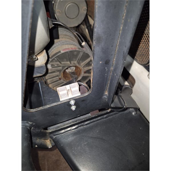

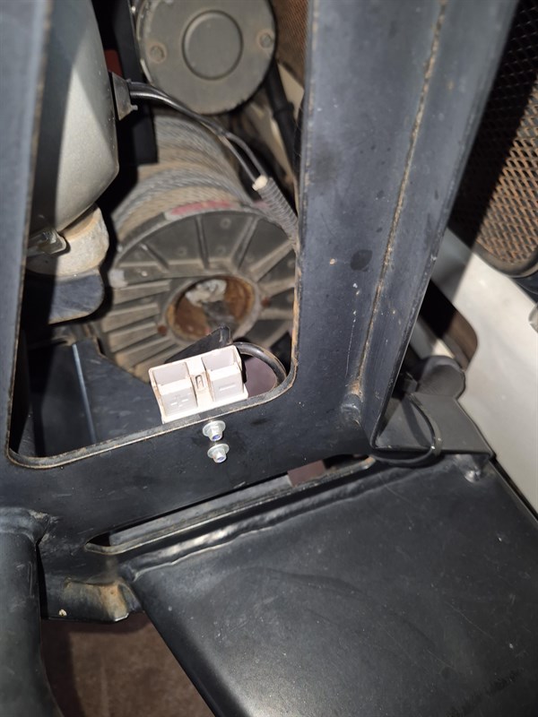

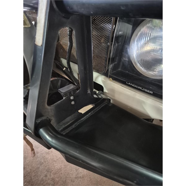

Hi Doc
I have one the 50A version of one of THESE
Anderson plug on front of car,(see photo's below) this also splits inside the vehicle, Anderson to Anderson in case I wanted to put a supply though the side window. Povo set up until a full rewire,which who knows when that will ever be.
Thinking I might see if I can get the tool-less MC4 connectors, make a short lead to Anderson, then just put a patch lead in between. That way I can use the patch lead (Anderson to Anderson)for other purposes.

Reply By: Member - lyndon NT - Tuesday, Mar 03, 2026 at 09:36
Probably should have posted these first. Input on Bull Bar.
Most likely only be plugged in when stationary.
I know, not ideal. But for the week or two this gets used for from time to time, it will be fine.
Panel connections up top will be under the panel itself.
