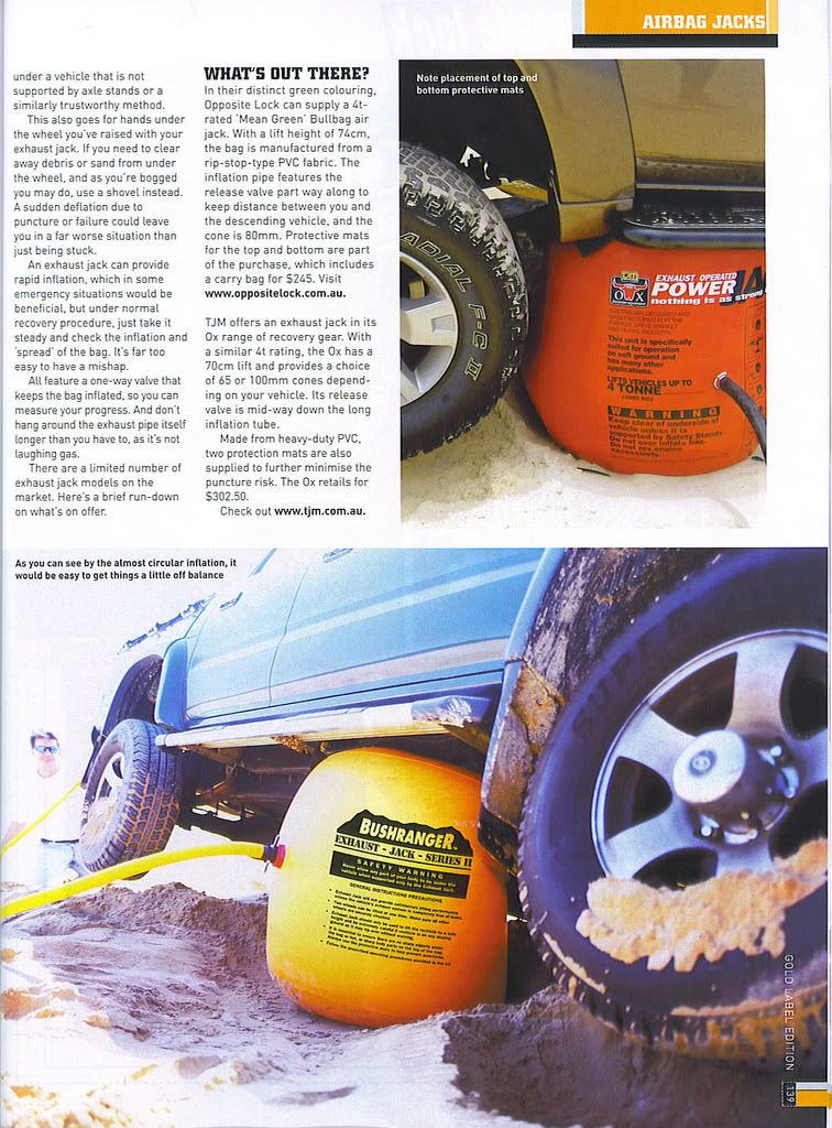

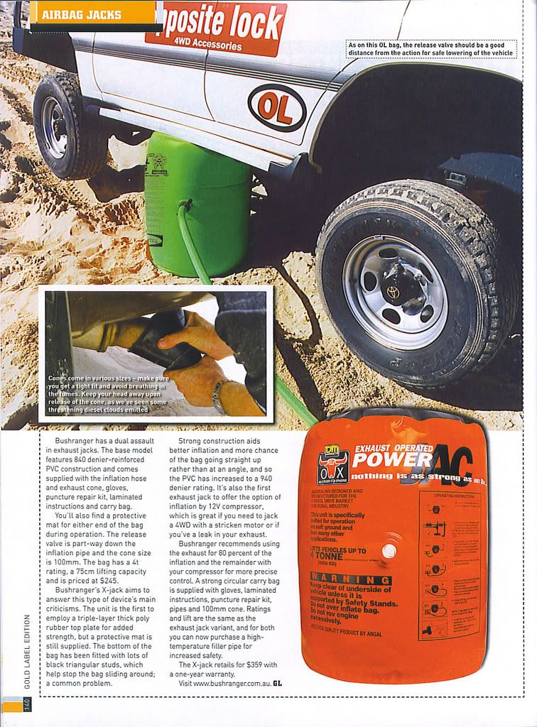

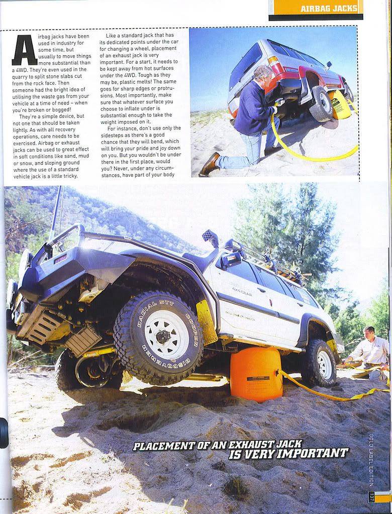

To Rob S - I rushed down to the newsagent and got the current edition of 4Wd Monthly - but couldn;t see any review - do you mean the August edition?
FollowupID: 517886
Follow Up By: Kev M (NSW) - Saturday, Aug 11, 2007 at 09:36
Sam,
The review is in the 4WD Monthly Gold Label Edition. 4WD Accessory Handbook. Vol 4 No.3
Hope that helps.
If you cant find a copy let me know and I'll scan the report and email it to you if you like.
Cheers Kev
Russell Coight:
FollowupID: 517893
Follow Up By: Sam Wolyniec - Saturday, Aug 11, 2007 at 09:44
Thanks Kev,
I would really appreciate that. I work in an area where the magazine selection is a pretty limited.....
Can you see my email address?
samwolyniec@gmail.com if you cant...
Sam.
FollowupID: 517894
Follow Up By: Kev M (NSW) - Saturday, Aug 11, 2007 at 09:59
Sent
Cheers Kev
Russell Coight:
FollowupID: 517896
Follow Up By: Sam Wolyniec - Saturday, Aug 11, 2007 at 10:06
THanks again - but the resolution was too low to read the text. Is it possible to increase the detail of the scan?
FollowupID: 517898
Follow Up By: Kev M (NSW) - Saturday, Aug 11, 2007 at 10:20
Sam,
Increase the image size and it will be able to be read, I had decreased the image sizes to reduce the size of the email that I had sent. If you still have problems I'll send them full size
Cheers Kev
Russell Coight:
FollowupID: 517901
Follow Up By: Sam Wolyniec - Saturday, Aug 11, 2007 at 10:23
ok - i'll have a play around and see how i go.
FollowupID: 517902
Follow Up By: Kev M (NSW) - Saturday, Aug 11, 2007 at 10:48
Sam,
Look at these
Russell Coight:
FollowupID: 517903
Follow Up By: Sam Wolyniec - Saturday, Aug 11, 2007 at 10:49
perfect!
I just found this on youtube about the x-jack which is alright too.
http://www.youtube.com/watch?v=A-dB6gc0Q7A&mode=related&search=
FollowupID: 517904
