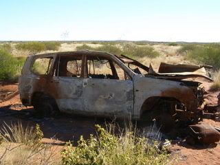

Rob
Doing the Canning once and not getting stuck does not mean that it is easy and everyone will not have a problem.
Making it sound easy is worse than telling it like it is.
I bet this Prado owner thought it was easy too.
Wayne
