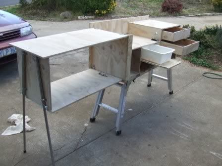

Well the camp kitchen is getting there, but I need your help with one last thing (I think it will be the last) I need some legs for my camp kitchen. I need to know where I might be able to buy some trestle type legs - or come up with a system that that doesn't look too shabby and works well to support one end of the kitchen while the other end is supported by the camp trailer. Any suggestions? I was thinking of welding something like the pic below, but I don't yet know how to weld and If I can get out of it and do it another way, then I’m hoping I can.
Drifta legs
Thanks in advance

I made a copy of a drifta kitchen and this is how I did my end legs.
They are cut down tent poles.
AnswerID: 274913
