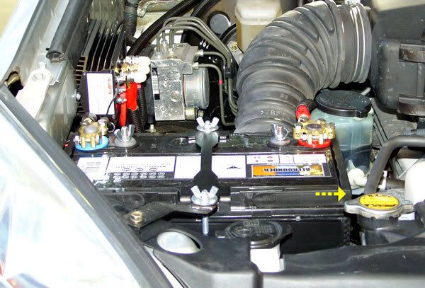

Fit the tray to the drivers side behind the headlight.
The TD120 is very easy as you don't need to move any power steering bits.
I will post a picture for you in a short while.

This is a picture of the petrol model, so ignore the power steering reservoir you see.
Note: Battery must clear the radiator spout (yellow arrow).
It is important that the top battery bracket is bolted to the cross-member for strength and to stop the battery rocking as this can cause the wheel arch to crack.
