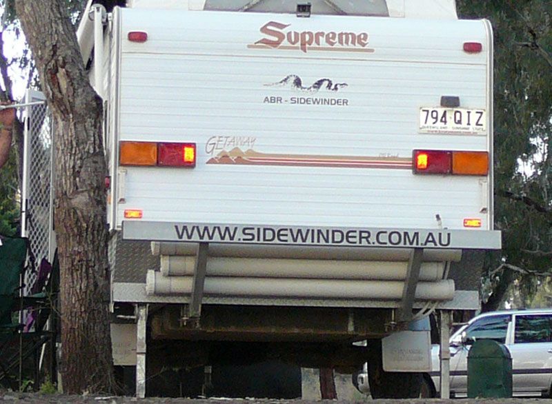

I force fill my 2 tanks one at a time through the drain taps.
Gets them 100% full and flushes them at the same time.
I have isolation taps between them on both the filler hose as well as the suction hose and use the tanks one at a time.
This worked well for me on my last Birdsville trip when we lost the water on the rear tank but the front tank was still 100% full.
Derek.

Follow Up By: ABR - SIDEWINDER - Sunday, Dec 20, 2009 at 18:37
If you look at this photo you will see my drains. They are long hoses that sit tucked away on the rear bumper with male garden hose fittings and caps on.
I simply pressure fill without needing to get under the van.
To drain I simply pop the caps off and lay the hoses on the ground.
Works very well.
