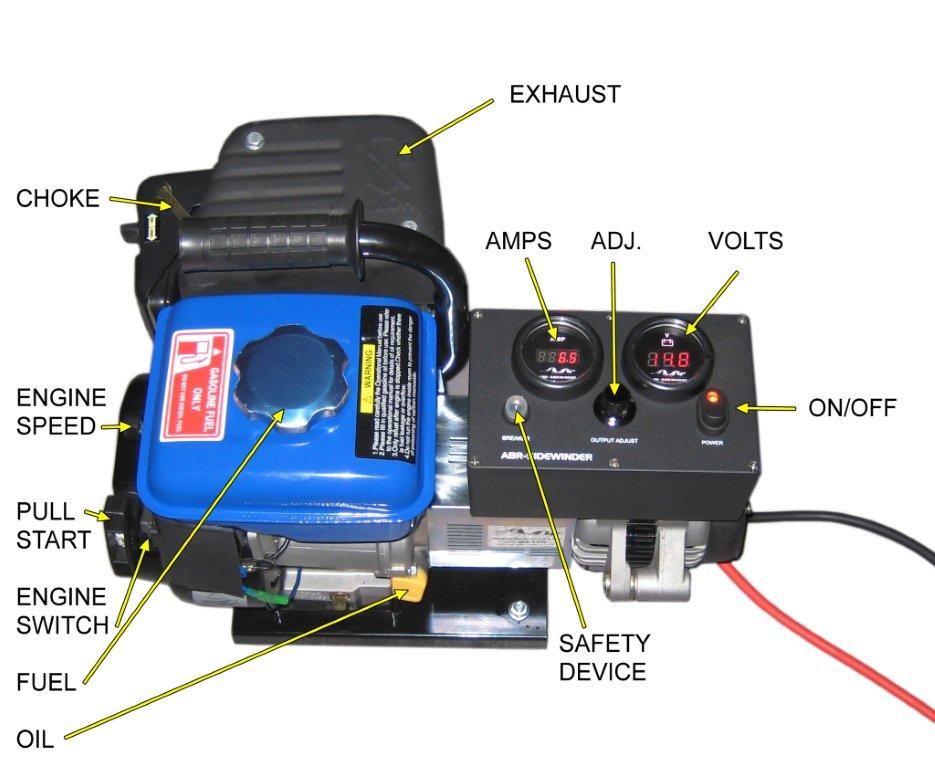

Follow Up By: ABR - SIDEWINDER - Thursday, Feb 04, 2010 at 23:09
Hi Flynnie
Yes they are faster than any other form of charger and cheaper than solar.
Christie do a 55A and 80A unit, ABR do a 70A unit. Each one has its place.
Noise is proportional to load, adjust to suit the location.
Allow about 500ml / h at full load.
Derek from ABR
FollowupID: 672226
