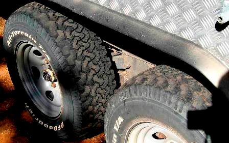

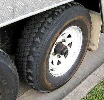

We had the Alko IRS on our tandem Phoenix and will be having it on our Davidson van currently on order. We're sticking with it as it's pretty much bullet proof and that's what matters to us. You can find plenty of reports of other types of suspension failing in one way or another but I'm yet to hear of one failure of the Alko IRS off road spec leaving an owner stranded.
When ordering, the van's GTM needs to be estimated as accurately as possible so that the rubber rating is ordered to suit. If rated too high the ride will be harsh and reduced tyre pressures are needed to compensate. It can also cause tyre wear, usually 'heel & toe', as the camber is also affected.
The Alko's not alone here. Other types of suspension can also suffer tyre wear. Here's another well known off road brand with tyre wear.
Many vans with the Alko IRS fitted have too high a rubber rating. A lot of owners wouldn't even be aware of it. It's seems to have been set for the ATM of the van not the GTM. The missing weight (ball weight) not sitting over the axles isn't providing the required compression on the rubber to allow the suspension to do it's job. This can also be caused by say not running with all water tanks filled which is usually considered in the GTM calculation.
Many vans (including our Phoenix) have had their axles re-rubbered to fix the harsh ride and tyre wear. Not a cheap fix ($3+k) so important to get it right the first time.
