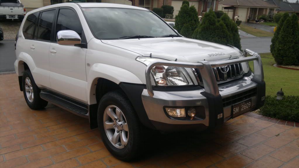

Hi Joe, I had the exact same vehicle bout 3 years ago,to be truly honest there a great car, very little to go wrong with them as long as like anything else its had oil and filter changes at least every 10k. They have a strong auto box (same as the 80 series) front diffs are probably the weakest link especailly if trying to do reverse snatches. Just check the high and low range work ok as most were shopping trolleys and never got shifted out of high four. Around town you will probably be looking at around 15L per 100 (myn used 17.2 but heavy foot and running bigger tyres, bullbar ect) Freeway around the 11.s (I got 11.8L per 100 towing camper,freeway driving) They have a bit of an exhaust drone at around the 2800/3000g mark when booting it say up hill and kicking the O/D out but they all do it just the design of the exhaust. Biggest mistake I did was going LPG hated it but just my opinion, heaps running around with duel fuel, just make sure they have the lube set up. The alternators dont like mud, will kill them real quickly. They did have a recall for rear axle seals but this should have been done with stickers on the inside of door jam if not can still be done. Obviously been auction there is no warranty unless your a dealer ?? So once you drive off as you know thats it. there are other little things like A/C gas/compressor check, windows etc but I presume your talkig anything major mechanical ?? As said mate great car, comfy, go ok, resonably quit, and flex pretty good from factory like this one, till the lift went in then it was even better
then got this one

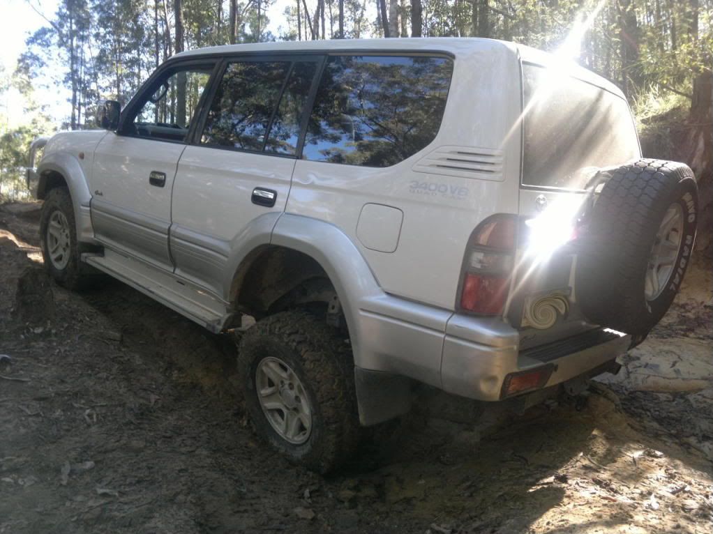

then have this one
So as you can see I reckon there a fantastic car, yes the 90 series (the one your talking abut is a tad narrow) but I never laid myn on its side either of them, I didnt think to much to the motor in the gold grande I had, gutless and prone to head issues, Just check behind the heads on the V6 to make sure its clean, you might get a tad of seepage but generally with high klms, I can tell you truthfully that my mate gave his 96 grande to his sister for nothing with 406 thou klms on it and still going, the only think that was stuffed on it when he handed it over was the aircon pump, it was cactuss but he serviced it by the book like he does his new one. You know the usual get under neath and eyeball everything, they did crack on inner guards but was mainly with winches, steel bullbar, dual batterys and heaps of corrugations, mine didnt have any and sold it with 170 on it. Not sure what $$ your looking at but they are fairly cheap now even private sales which Im sure you have done your home work. All the best with it
