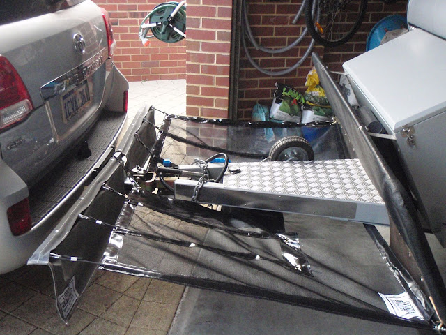

Reply By: Member - Captain (WA) - Sunday, Jan 08, 2012 at 16:16
After having a vinyl protector on the front of my previous caravan, rock tamer style mudflaps on both my old cruiser and GU, I now have a Stone Stomper on my Quantum. I can say from experience that the Stone Stomper is miles in front of the others.
While the vinyl protector stops the smaller stones marking the van, the front of the drawbar is peppered with rocks and they bounce back onto the vehicle. The drawbar carries many stone scars and the large rocks still dent the front of the van.
A full length rear mudflap was added and while this helped, on the tracks with high centres, the mudflap would drag and flick up even more rocks. Was lucky not to break a rear window. Raising the mudflap to clear the high crown allowed rocks to come underneath, sorta defeated the purpose.
My Camprite had a full width stone deflector and while this protected the camper, the drawbar was peppered even with the full length mudflap, the rear of the vehicle had the odd mark from a rebounding rock.
With my Quantum, I went the Stone Stomper and it has been close to perfect. The drawbar looks like brand new while the stone stomper canvas flap is showing the signs of hard use, the canvas corner with steel bar underneath takes the full brunt of stones from the rear wheels and this is showing signs of wear on the corners. Below is a pic when it was new.
Pic on Great Central Road enroute to Uluru
Captain
