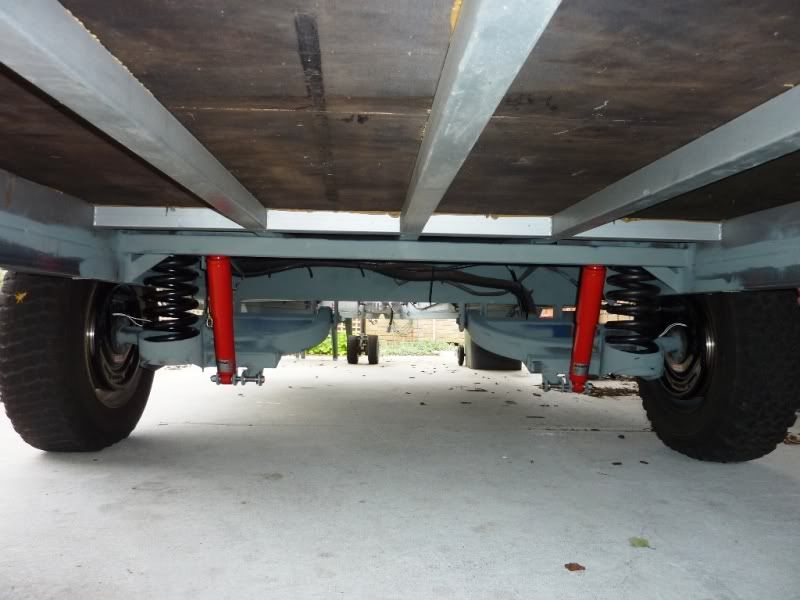

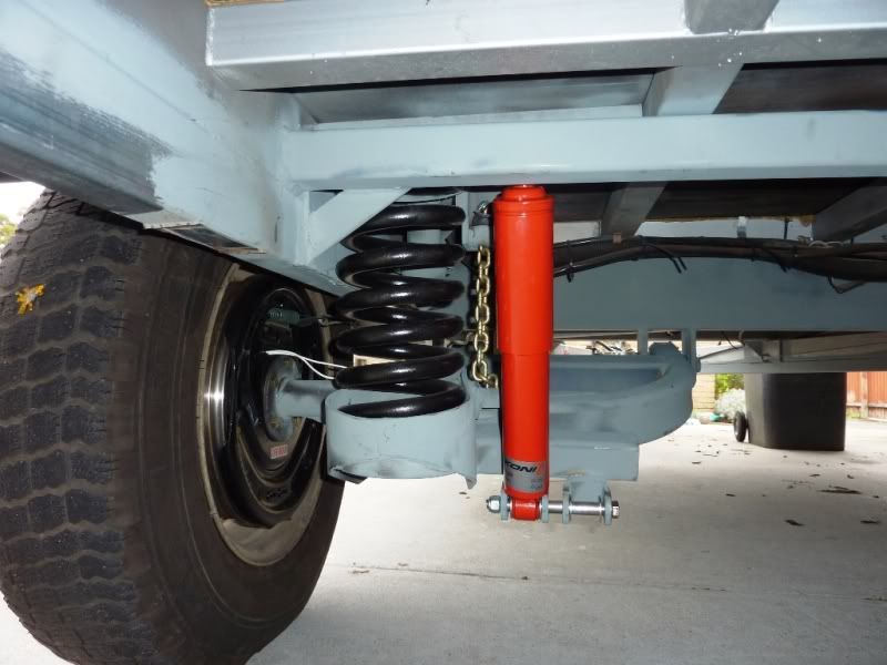

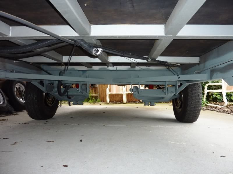

In my instance, I can't afford a new or even 2nd hand "offroad" van with independant suspension so I went about converting the "onroad" van I already own.
My wife an I are basically happy with it and we own it outright so I went down the line of stiffening the chassis myself (I'm a full time welder so that side of things didn't worry me at all.)
I researched a bit about the Vehicle Components system, the Control Rider system from G&S Chassis and in the end decided on retro fitting a SugarGlider system from Withers Engineering as it seemed to tick all the boxes for me.
I had the guys at Withers Engineering fit the suspension and associated crossbars and bracing as they have the experience and overall the fitting of the suspension was only a small part of the actual cost.
You will notice on the pics below it's set up for twin shock absorbers per wheel. I was at my limit money wise so Neville optioned it up so I could fit the shocks at a later stage if I feel I needed it.
I've only had it back a week and I've still got lots of work to do on the van fitting drop down legs, water tanks etc, so I haven't had a chance to put it through its paces but I'm confident it will suit my needs well.
The pics below give an idea of how the SugarGlider system is installed.
Regards Andrew.

Hi Andrew,
That looks a really robust job. Well done.
Your springs look larger than mine..what size are they (diametre)?
Very solid looking job.

The springs are 22mm diameter but you have to take into account that the weight of my van (currently 1530 kgs as it sits with an estimated ATM of between 1900 and 2000 kgs) is supported by one axle set not 2 like yours, so the spring rate must be higher.
Removing the square 50mm axle/leaf spring assembly and changing to the SugarGlider has increased the weight by around 110-120 Kgs (We weighed it before and after). I'm not too unhappy with that as there is some serious steel work in both the arms and the associated crossmembers they are mounted to.
I'll probably go down the route of twin shocks per wheel like your VC system as finances allow.
My priorities are drop down legs, water tanks and some extra stiffening of the outriders that support the body walls of the van.
Once those are done, I can at least use the van and then it's down the battery/solar power path so I can experience the free camping lifestyle.
Regards Andrew.
