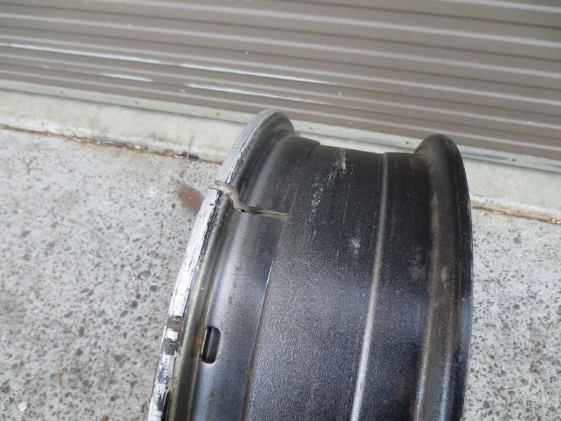

Toyota still uses them because there are tyres that are used in some situations in four wheel driving that are so heavily constructed that it would be impossible to get them on and off a one piece rim in the bush by hand. I doubt if some could be removed and replaced even with a tyre changing machine.
The photo of the Nissan Patrol below was posted on this site a few years ago. The tyre is a 7.50 x 16 MRF Superlug cross ply with ZERO air pressure in it. The side walls are so heavy, the weight of the car is not enough to flatten them. Tyres like that are used extensively in the Outback, particularly for cross country work on the large stations.
The photo of the punctured tyre shows a typical bush puncture. I have seen punctures like that in remote Outback areas as well as coastal mountain tracks. You can not fix something like that with a plug kit. The tyre has to come off the rim in order to fit a large multi ply reinforced patch and most likely a tube.. If you are not capable of getting your tyres off a one piece rim yourself then a split rim will make it about 100% easier.
The safety aspect is not really an issue at all providing the wheel is not damaged or just about rusted away. The first photo below shows the removable rim in place. Note how the inner surface of it forms the seat for the tyre bead and is identical in shape to the other side of the rim. It simply stretches out like a circlip and snaps into a grove around the edge of the rim.
The second one shows the size of the grove and how the rim fits into it. When you inflate the tyre, the walls slowly slide out and can not exert any side pressure on the wheel until it contacts the sides of the rim on both sides. From that point on the walls will try and push out sideways against the edges of the wheel but there is no way in the world they are going to push that removable rim up out of its grove allowing it to fly off when the steel reinforced bead of the tyre is sitting directly on top of it. You could inflate the tyre until it burst and the rim would still stay in place.
It is a bit like placing a circlip into a grove on a gear box main shaft then placing a radiator hose clamp tightly on top of it. Now try and get the circlip out without removing the hose clamp. A split rim with a tyre bead sitting on top of it is exactly the same thing.
I have worked with split rims since my apprenticeship days in the 1960s. I have never had to put them into restraining cages, get an elephant to sit on them or run out 100 metes of air line so I could stand back a bit. They have been designed to be used safely and they are safe.
Problems with water and sand entry into split rims can be easily overcome with a little silicon roof and gutter sealer from a hardware store. Simply fill the hole around the tube stem and the gap in the removable ring then smear a tiny bead right around between the ring and the wheel.

Reply By: The Bantam - Tuesday, Nov 06, 2012 at 11:10
On the matter the original poster raised about different pressures front and back.
It depends on the vehicle and how it is loaded.
if there is more weight on the rear axle than the front, it requires more pressure its that simple.
most pasenger cars ( station waggon 4wds may come into this group) have a pretty even weight distribution front and rear, so running the same tyre pressures front and rear may be appropriate.
BUT for example...hilux and landcruser utes carry most of the aditional load on the rear axle....laden and unladen the recommended front tyre pressure remains the same, but the rear tyre pressure is incerased considerably under the full load situation.
This is why when you are setting up your vehicle for a trip you need to weigh it and get seperate figures for each axle and then calculate the required pressure from the load V pressure tables.
As for the split rims debate...a lot of the discussion is emotional and the fact is most times they are relaced, is because of looks...although most will not admit it.
AnswerID: 498021
