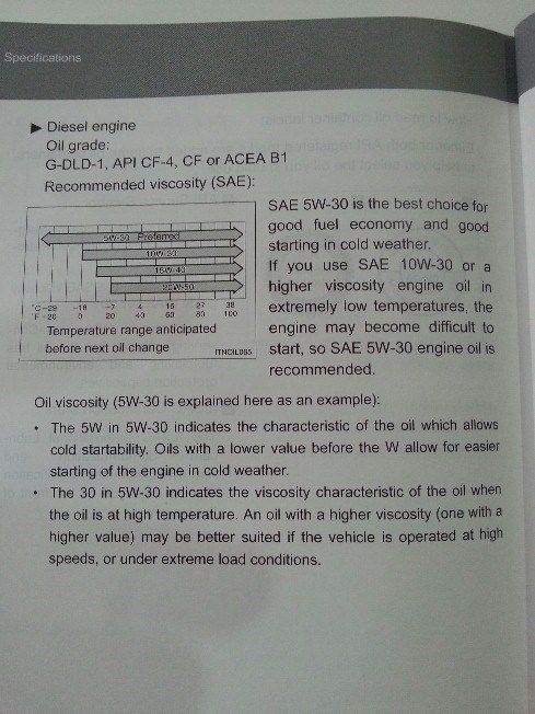

Reply By: craigandej - Thursday, Nov 15, 2012 at 10:49
I cant upload the table, but 20w-50 or 15w-40 would seem more suitable giving that 15w-40 shows temps down to -12 or so. OK so who uses thin oil and who uses the thicker stuff ?(in non tech terms). Think I may have opened a can of worms here!!!

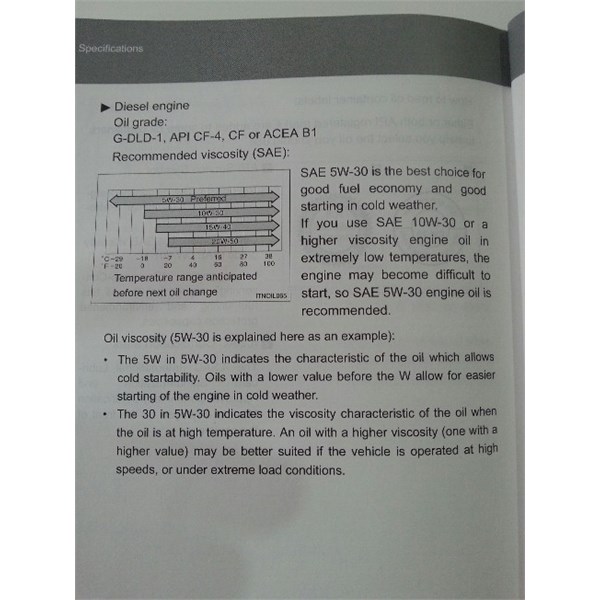

Reply By: Member - Phil G (SA) - Thursday, Nov 15, 2012 at 11:41
If you read the manual, then why whould anyone not use 5W30???
Here is page 564 from the 200series manual:
AnswerID: 498566
Follow Up By: Charlie B2 - Thursday, Nov 15, 2012 at 13:04
Hi Phil,
I think you may have answered your own question with that copy - the last couple of lines probably say it all ! I'd suggest that most touring vehicles may be under "extreme load conditions". :-)
Now, if we could only get hold of a great 0W - 60 with the right specs for less than $5 a litre, I reckon we'd have the whole thing sorted! :-)

Follow Up By: Member - Phil G (SA) - Thursday, Nov 15, 2012 at 14:47
Gday Charlie,
Depends on what we call "extreme".
If a 200series was pulling a 3.5T van at 110kph in the north of Australia, then maybe you'd want 40 weight oil.
But 99% of these motors are underworked and the 5W30 is recommended.
