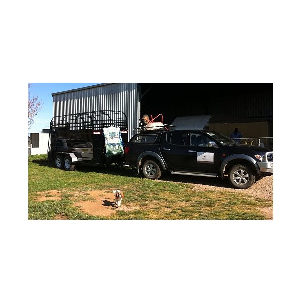

My Daughter tows a large trailer with a 2007 Auto Triton, V6. it carries 2 large Braford Bulls and this weekend and last weekend we went down near Wellington and the Triton towed the trailer near full of Hay bales back to Orange. The Triton handles the job with ease although I do think the Turbo Diesel would be better in the hilly country.

How's the "cattle dog" in the photo go rounding up the bulls?
FollowupID: 779612
Follow Up By: Life Member - Doug T (NT) - Sunday, Jan 20, 2013 at 11:17
IronMan
He does ok when all the Poodles back him up.
