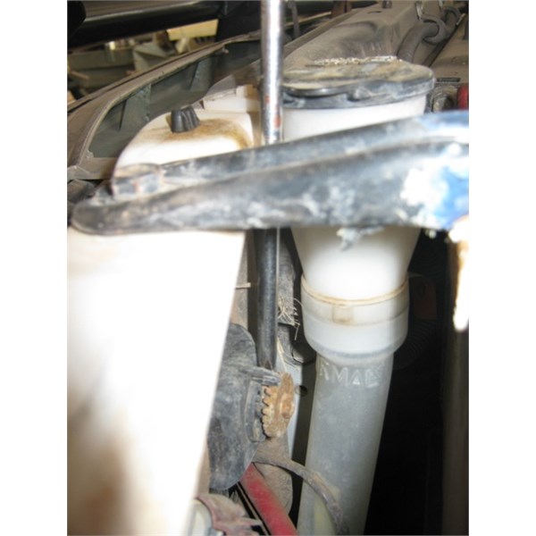

Any one with a Landcruiser 100 series and have you adjusted the headlights in your vehicle yourself?……..My drivers side headlight beam High/Low is a bit high and needs to be lowered, there is nothing in the Owners manual telling you the way to adjust them.

There is two hex srew heads either side of of the globe holder, 1 at the top right hand side of the headlight assembly the other to the the left hand side off the off the globe holder.

In the 100's section at Lcool.org (Landcruisers Online) you can search for headlight adjustment - a number of posts come up - this is one of them.... [http://www.lcool.org/forum/viewtopic.php?t=6341&highlight=adjust+headlights ]. As you can see, there is a couple of wheels at the back of the lamps, each with a hex nut in the centre...BUT they are designed to allow for a long shaft phillips head screwdriver to be inserted from above - the driver's grooves turn the teeth on the outer edge of the wheel - very neat.
