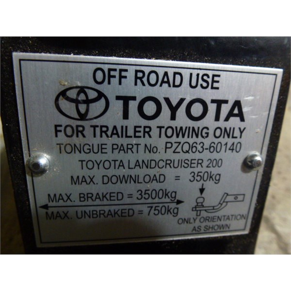

Reply By: Member - Phil G (SA) - Tuesday, Mar 05, 2013 at 22:55
Gday Rosco,
Maybe some do and some don't. 200 series can only go in one way, going by the diagram on the bottom RH corner:
AnswerID: 506138
Follow Up By: Member - Rosco from way back - Tuesday, Mar 05, 2013 at 23:08
Interesting ... certainly looks like it.
However this one is different. Note the gusset under the bent plate as shown in the diagram (I would say down the centre of the plate).
This gusset is loaded in compression with hitch loaded as shown, with the same gusset being loaded in tension if the hitch were to be inverted.
This would definitely have a significant impact.
Which puts it in a class of its own or with similar, whilst those without the gusset are also similar in a different group of sames.
Make sense ???
FollowupID: 783092
