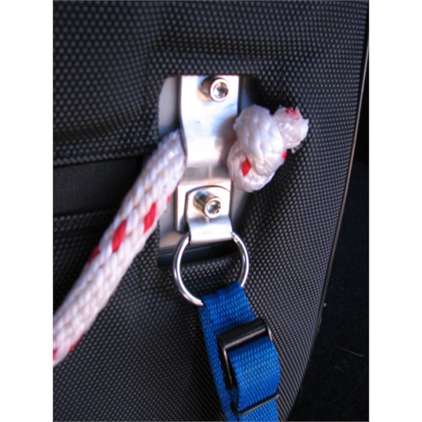

I have a 40 litre Waeco and had the same problem so I made a couple of metal saddles (to fit the original bolts) that go over a rope handle. Added a couple of rings to tie it all down,
Waeco fridge handle

Hi David,
A picture paints a thousand words! Thanks so very much for your solution - that is so useful. I've got some work to do this weekend now. Very much appreciated ... Alan
