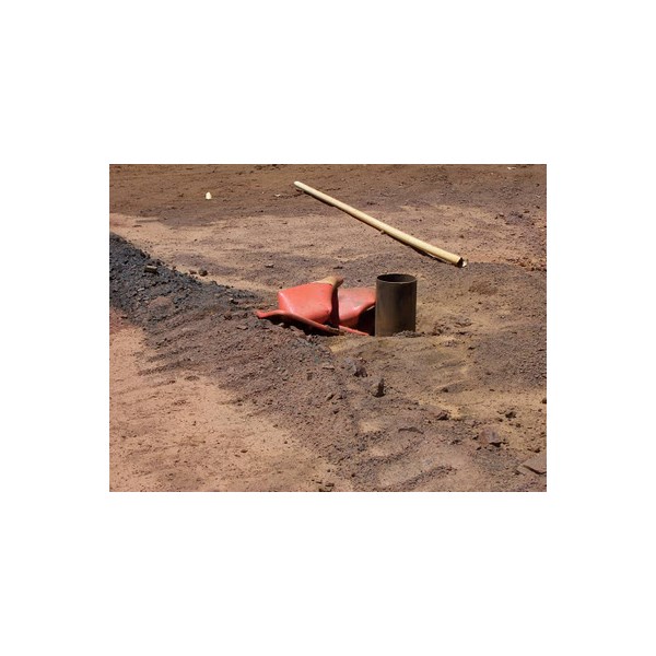

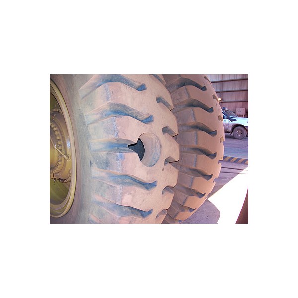

Seeing you all have mastered the repair on a pup, do you reckon you could fix this for us. Boss is a little cranky.
Bugger another staked tyre

Yeah I think we've got a patch for that. Holy hell, you best let us know the story to that large disaster. It looks like a very neat plug cutter has been at work. Ran over a verticle pipe end perhaps?

Follow Up By: Rockape - Monday, Mar 11, 2013 at 14:27
Micko,
you got it in one. A piece of pipe sticking out of the ground. Maybe this is why no one smokes pipes anymore. To expensive. LOL.

Follow Up By: Mick O - Monday, Mar 11, 2013 at 14:51
Well there's how we fix it. Go find that bloody pipe and knock out the plug. A bit (ok maybe a lot) of Maverick Bond and a lick of silicone around the inside and she's done. What do you reckon RA?

Follow Up By: Member - John (Vic) - Monday, Mar 11, 2013 at 15:24
Not surprised the boss was cranky.
That's an amazing puncture in anyone's book.

Follow Up By: Rockape - Monday, Mar 11, 2013 at 16:21
Here it is the perfect holepunch.
