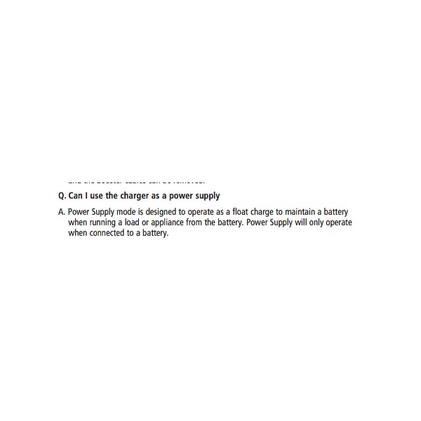

Sorry.. But the Projecta will not run 12 volt appliances on supply mode unless the battery is there as a host, I believe there are chargers that can supply a constant 13.7 volt direct to an appliance with out the need for a battery. Is this so??
Daz
FollowupID: 785018
Follow Up By: Allan B (Member, SunCoast) - Thursday, Mar 28, 2013 at 12:32
Yes Daz, You are correct that the Projecta charger will not operate in 'power supply' mode unless a battery is connected. It then operates in a constant 'float' mode at 13.8 volts.
