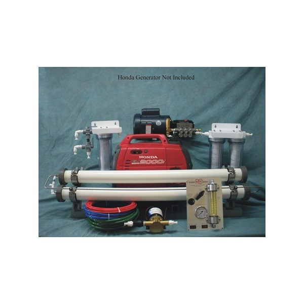

Follow Up By: Member - John and Val - Tuesday, Apr 09, 2013 at 08:02
Couldn't find the Gold Coast source, but this sort of answers my questions :
Costs a bit over $4000, plus the cost of the generator to run it.
Think at that price I'd sooner carry a couple of 25 litre containers for potable water, and use wet wipes instead of a shower!
J and V
- Albert Einstein
FollowupID: 786076
Follow Up By: Nomadic Navara - Tuesday, Apr 09, 2013 at 09:19
John, that system is like towing your van with a large truck. The OP is requiring 20 gallons a day of fresh water not 20 gallons per hour. The page of links above have units there that will satisfy his demand for $200 or slightly more. There is no need to give ridiculous examples.
