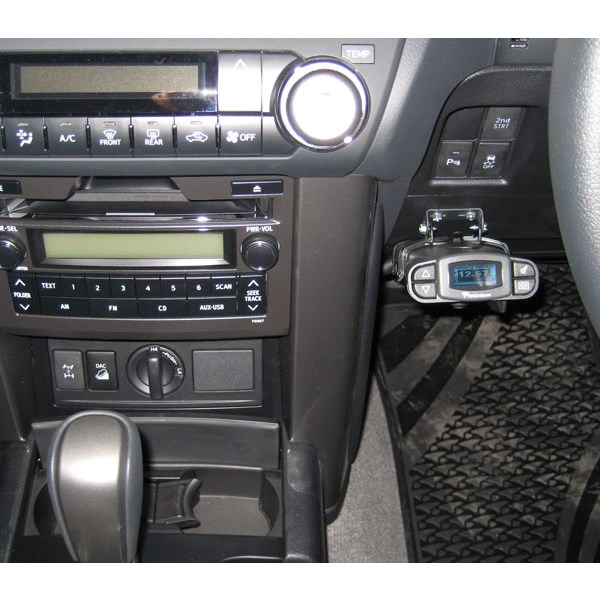

I was wondering where people are fitting the brake control unit to a 150 Prado.I am concerned of a clsh with the knee air bag

I have the redarc which I mounted under the radio stack forward of the gear stick. It did not need to be mounted o a particular angle. Have a look on prado point.com, there is heaps of info and pics there.

Hi. Mine is a 2012 GXL. I fitted a Prodigy P2 just above the Knee airbag on the LH side of the columb. It fitted neatly and there is just enough room to touch the reverse sensor on/off button. Cheers,Bob

Apart from that we have a 150 and 120 and the controller is mounted on the RHS of the steering column low down on the dash panel. This is clear of the knee airbag deployment and also of legs
