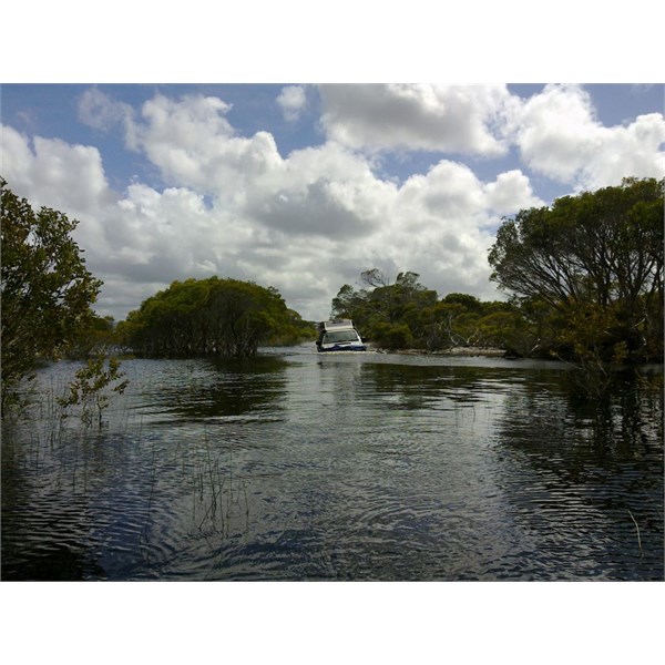

If you do stuff like this, then yes :-)

Follow Up By: edwin - Wednesday, Apr 24, 2013 at 11:07
Hi Tony, is that the track to lookout point, that some long crossing from memory,crocs too apparently , I chickened out of that one due to no snorkel.
Ed

Follow Up By: Tonyfish#58 - Wednesday, Apr 24, 2013 at 17:29
Edwin - You are correct
RegardsTony
