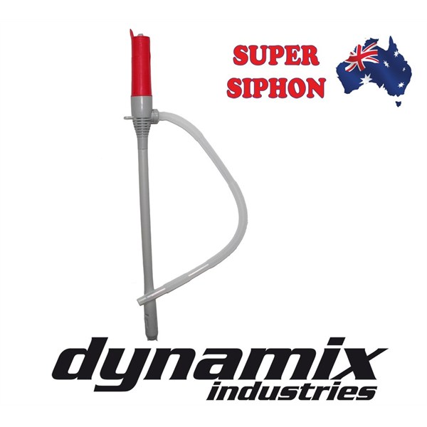

I purchased this little Gem and it is good for both Diesel and Petrol.
Beut Little pump.
I have been using it intermittently for around 6 months and have found it great to use and so far have not had to replace the 2 "D" sized batteries.
It would not be much use on a 200ltr drum but is great for topping upthe generator chain saw and the Mower.
Cheers Dodg.

Thanks Dodg - almost missed this little gem - certainly fits the budget. Will research your link.
