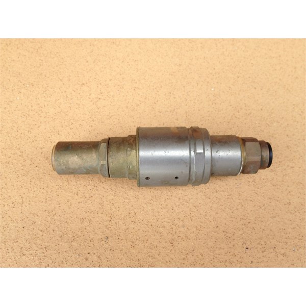

Hi. I have a 2010 Jayco Sterling. On the inlet pipe it has a pressure reducing valve. It is a brass cylinder device that has a spring loaded diaphram inside. This reduces the high water presure that some communities town water has. It also seats against an internal face and stops water backflowing up the pipe when there is no pressure from outside. It sounds like yours has possible something under the seat or has somehow failed. I have read there is a plastic version too. Maybe follow the inlet pipe from the start and see what you can find. Cheers,Bob.

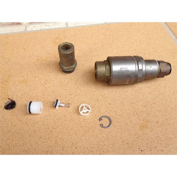

This is mine disassembled after the gauze screen became blocked from river water
