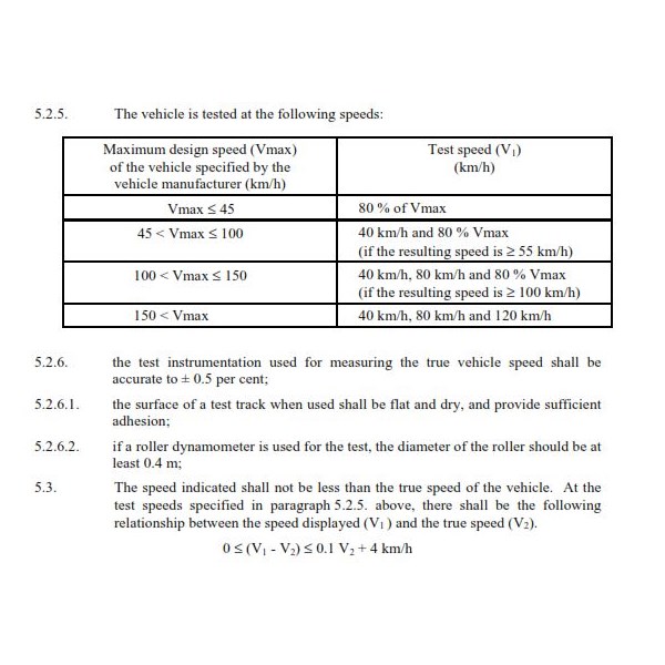

Speedometers are governed ADR-15. Search for it to get the complete PDF file. The following is the section on speedometer calibration
AnswerID: 515930
Follow Up By: Nigel Migraine - Tuesday, Aug 06, 2013 at 17:52
Goodness! A man who follows logic, reason, investigation and the production of evidence! What are you doing on this forum?
FollowupID: 795298
