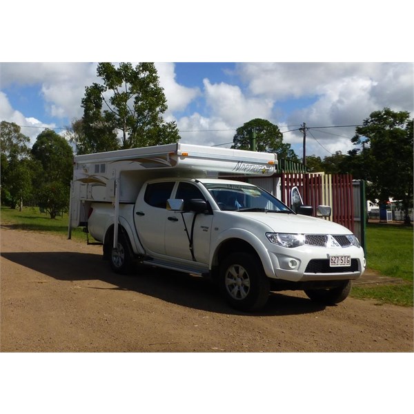

Hi, we are planing to do the
Birdsville and
Oodnadatta Tracks in September 2013 with a Mitsubishi Triton 4x4 with a Northstar Slide-On. I would like some advice regarding safety, tyres,
fuel etc. Would I need to protect the rear of the vehicle from stones etc? Also would October still be a good month to travel - not to hot - if we are not able to get away earlier? We have not had much experience with 4x4 driving but from what I read these tracks are ok to travel with due care. Thanks

Oodnadatta about six weeks ago and it was no trouble at all. I am a bit concerned though about the amount of weight it looks like you have hanging off the back of your car. While I was camped at the
William Creek caravan
park, another Triton drove in with a bent chassis. All makes do it, it is not confined to Tritons only. The owner knew he had a lot of weight
well back behind the axle but he did not realise the problems it can cause. As the weight slams down on rough surfaces, it generates forces far above its static weight. The back of the car goes down and tries to lift the front. On this particular car, it cracked the chassis across the top flange at the front of the forward mount for the tray and opened up a V down each side.
The car did not have air bags but the vast majority of utes that bend their chassis do. They usually compress the lower flange of the chassis as it bends. The bags get progressively harder as they compress, unlike the original springs that compress at a constant rate. They are like sitting the chassis on oversize bump rubbers.
Keep in mind when loading dual cab utes that they are essentially a five seater car with an open rear section. In order to get them up to their maximum capacity, you must have five heavy people in the cabin. You can't have a little bit of weight in the front and heaps out the back.

Thank you for the advise re weight. I will put most of my extra stuff on the back seats. Also driving slow as we are under no time constrains. As said before we have not done much 4x4 driving but have driven from
Brisbane to
Perth which also includes a few lonely stretches of road. From what I understand speed is a big contributor to
the bend chassis?
Well I will have the car checked by the dealer and RACQ to get their opinions. We also will take the legs off and store them on the back
seat or maybe even leave them at home.
Thanks again Evi

Thanks for all the good advise. I do have upgraded
suspension and no airbags and we do intend to load quite a bit of gear onto the rear seats, leaving the slide-on as light as possible. We intend to take it fairly easy going slowly as we are not in a rush. So 3 days at least.
